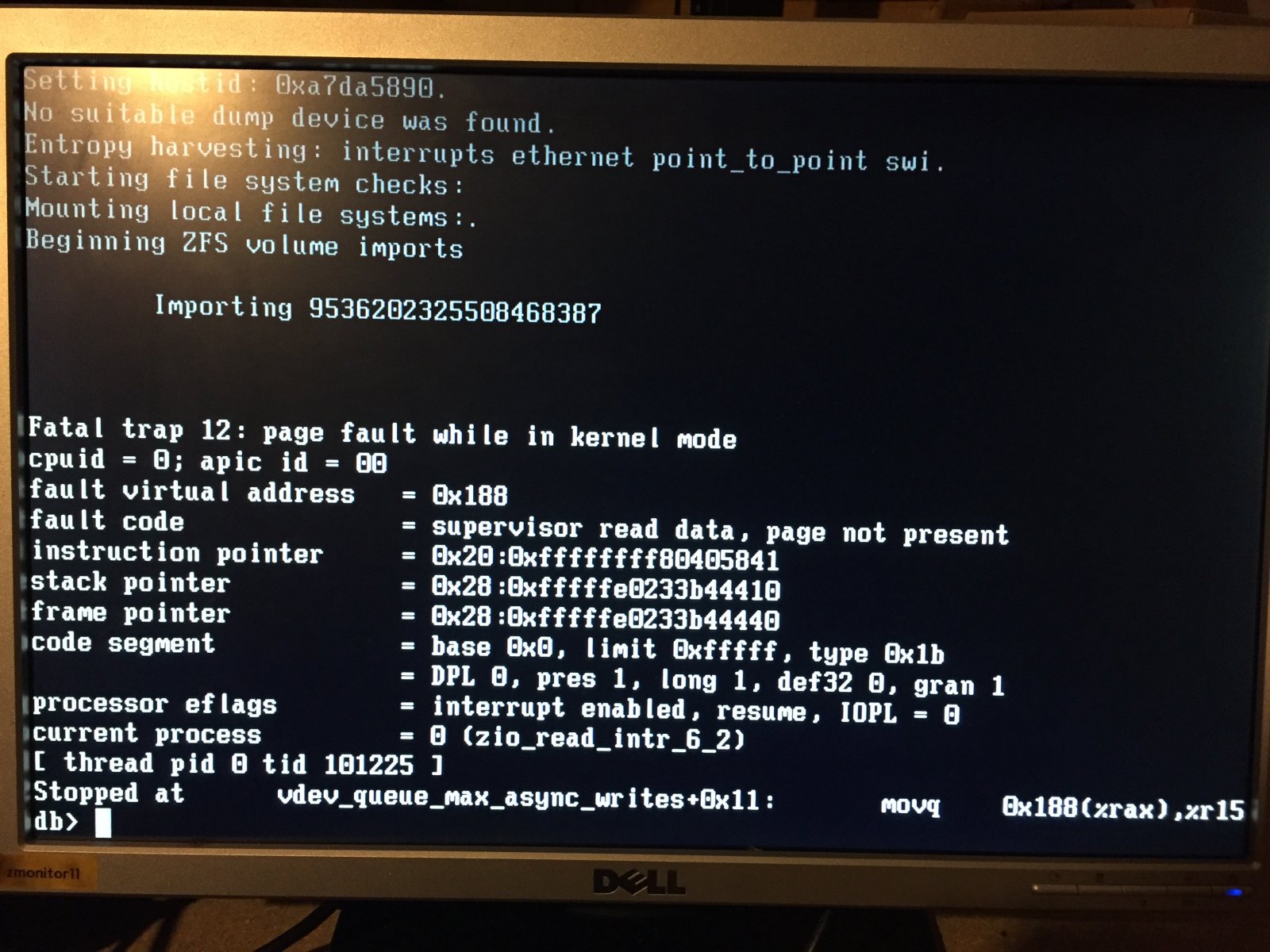

Hi all,
Hope someone can guide me or break the bad news. I'm ZFS and BSD newbie. I'm seeing this problem, which occurred on its own and took NAS service away and I'm trying to troubleshoot. Below is the screenshot of the problem

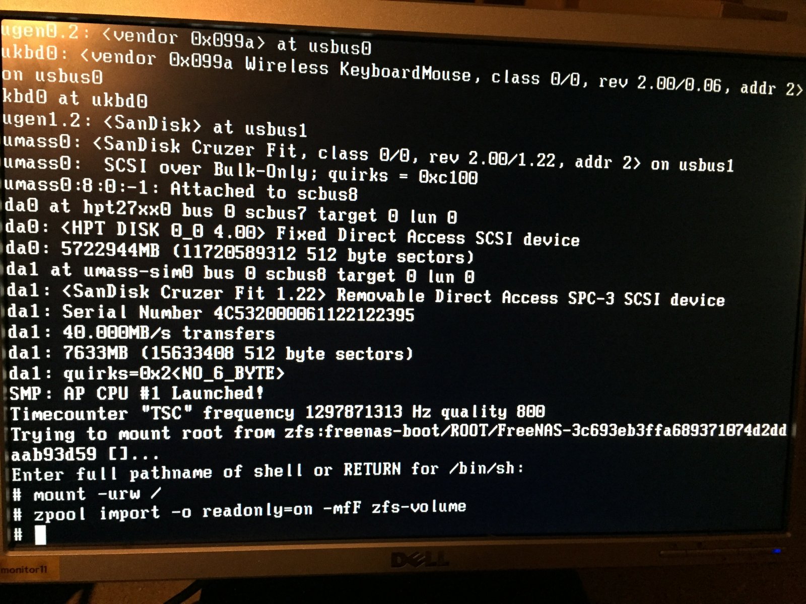

- I can login to 'single user mode' and am able to mount zfs volume in read-only. (through which I have copied most of the important data)
- If I try to change zfs volume the to read/write (reading instructions from here - https://docs.oracle.com/cd/E36784_01/html/E36835/gazuf.html) I'm seeing the same page fault error.
- If I exit 'single user mode' system boots but complains about the read-only file system, but none of the services come up.

Based on what you have posted and da0 appears to be a single 5.7TB drive, it appears that you are using FreeNAS incorrectly and you are using a RAID controller in RAID5 configuration. This is not good. If this is not the case then please clarify.

@joeschmuck, yes it shows up as one drive as RAID is managed by RocketRAID. I use to run a Linux on the same hardware before I switched to FreeNAS 3 years ago. And have had no problem from last three years until now.
