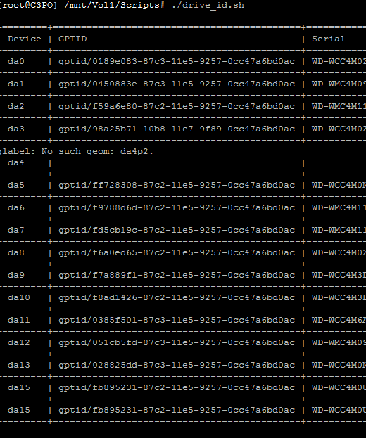

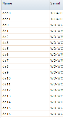

Hey all.
I've gone though all the steps but I am confusing myself. My system has been running great for over a year and now a hikup. I had a drive fail a few weeks ago and my spare took over, great. Now I have a drive giving me read errors. I want to pop out the failed drive, where ever that is, reformat it and test it then try to put it back in. I think it failed due to frequent power outages. I know I know... get a freaking UPS. I will, eventually.
So below is what I have found but I can't put 2 and 2 together to find the failed drive, then find the "trouble" drive. I think da11 is my trouble drive but if that is so, then where is the failed drive?
And then to find the failed drive in my Supermicro Chassis... I think this is the right steps? http://serverfault.com/questions/261779/how-to-determine-which-disk-failed-in-a-freenas-zfs-setup

Acutally it could be da6...
ID# ATTRIBUTE_NAME FLAG VALUE WORST THRESH TYPE UPDATED WHEN_FAILED RAW_VALUE
1 Raw_Read_Error_Rate 0x002f 200 200 051 Pre-fail Always - 0
3 Spin_Up_Time 0x0027 178 174 021 Pre-fail Always - 4058
4 Start_Stop_Count 0x0032 100 100 000 Old_age Always - 147
5 Reallocated_Sector_Ct 0x0033 200 200 140 Pre-fail Always - 0
7 Seek_Error_Rate 0x002e 100 253 000 Old_age Always - 0
9 Power_On_Hours 0x0032 068 068 000 Old_age Always - 23376
10 Spin_Retry_Count 0x0032 100 100 000 Old_age Always - 0
11 Calibration_Retry_Count 0x0032 100 100 000 Old_age Always - 0
12 Power_Cycle_Count 0x0032 100 100 000 Old_age Always - 147
192 Power-Off_Retract_Count 0x0032 200 200 000 Old_age Always - 137
193 Load_Cycle_Count 0x0032 200 200 000 Old_age Always - 9
194 Temperature_Celsius 0x0022 111 106 000 Old_age Always - 36
196 Reallocated_Event_Count 0x0032 200 200 000 Old_age Always - 0
197 Current_Pending_Sector 0x0032 200 200 000 Old_age Always - 0
198 Offline_Uncorrectable 0x0030 100 253 000 Old_age Offline - 0

Ok so now and odd issue when trying to find the missing drive. da15 shows up twice and da16 is missing. I have 17 drives in the chassis. Also da4 has an error when running the script.
And looking at the drives in the GUI da4 is missing but da16 shows up. I'm not sure how to intemperate this issue.
Fuganater
Sep 28, 2015
477
So in this case da4 is my bad drive that the spare replaced?
Robert Trevellyan
Pony Wrangler
May 16, 2014
3,778
Apparently. The point is that the list of serial numbers you're seeing in the GUI is likely the one you need to check against the physical disks.
