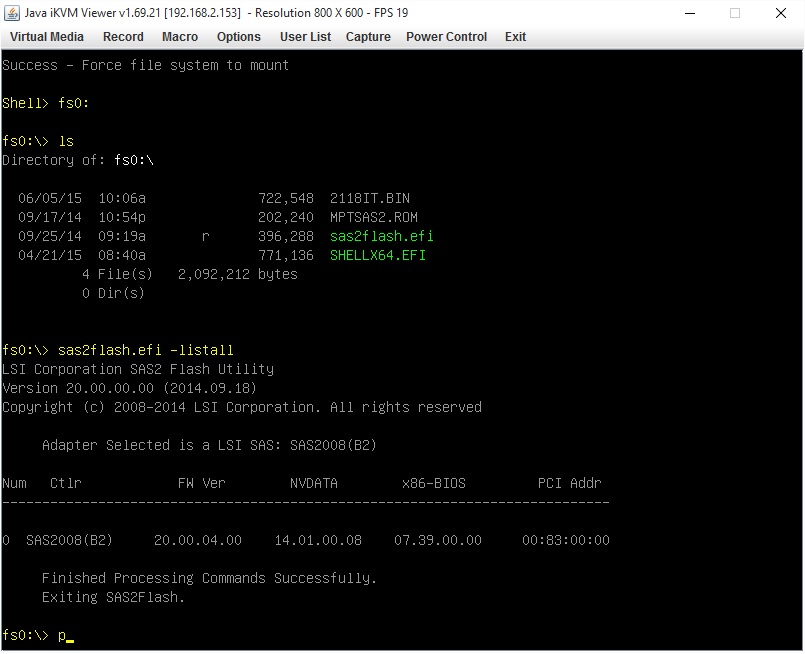

I swapped out the new backplane and I still get the same write errors. It is fine for data up to like 30GB but when I move more than that, I start getting write errors.
Could it be the firmware on the HBA? It is a LSI 9211-8i with P20, would P19 be any better?

jgreco
Resident Grinch
May 29, 2011
18,680
What SPECIFIC revision of firmware is on there? 20.00.04?
Fuganater
Sep 28, 2015
477
