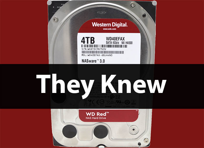

May be a timeout because the SMR drive is busy with housekeeping.

WD-WD60EFAX-68SHWN0
I didn't look the model number up. If all your drives are that model, it is bad news for your pool. The SMR drives are terrible with ZFS. So bad that WD came out with a new model of drive recently.

this issue re-occured, so I checked. They are all SMR WD drives. Looks like I need to replace them one by one as they smart test fail. the weird thing is that they show SMART test passed ok when I run smartctl -a

Its not a smart issue (per se). ZFS and SMR simply do not mix well. You need to replace all of the disks, not just one at a time.
Everytime you replace a disk the pool re-silvers - this will take forever and trash the crap out of the existing HDD's. Then you do it again, and again, and again, and again, and again (rinse and repeat). This process could take months during which your data will be at risk
Backup the pool, remove and replace all disks then restore the pool
If you can attach the new disks in parallel, you can actually resilver as many as will fit in one go.

this is crazy. you're saying the SMR drives won't survive the re-silvering time it will take to replace them? I have 12 drives 2 6 drive vdevs. The pool is in a 36 bay super micro so I could build a new pool and copy the data from the one pool to the other easy enough. But you're saying these SMR drives are so crap I need to replace them now?
I have 2 vdevs with 6 6TB drives in each. You're saying I could replace one drive in each vdev simultaneously.
Without loss of redundancy, you can replace as many disks as you can attach at once. If you can't attach additional disks and have two RAIDZ2 vdevs or something similar, which you imply you do, you could also conceivably remove one drive from each vdev and thus replace two disks at a time.

So - the only options I can suggest are:
1. Build an entirely new Pool with new CMR disks and copy the data over. Then send the SMR disks back to WD for replacement as not fit for purpose. You might get lucky. This is by far the better solution - much much safer
2. Replace a single disk in each vdev and resilver, repeat five more times. Make sure you have a good backup cos the disks may not survive (and you may not survive the wait)
