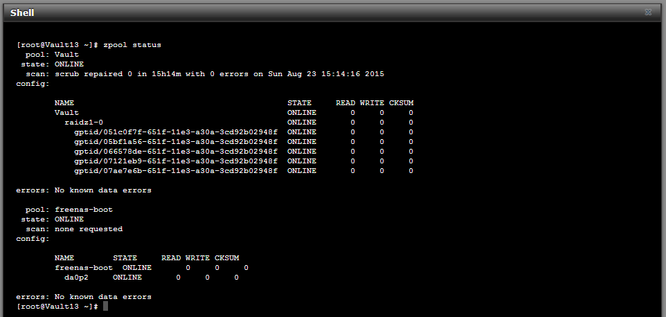

The zpool status shows the volume as online:

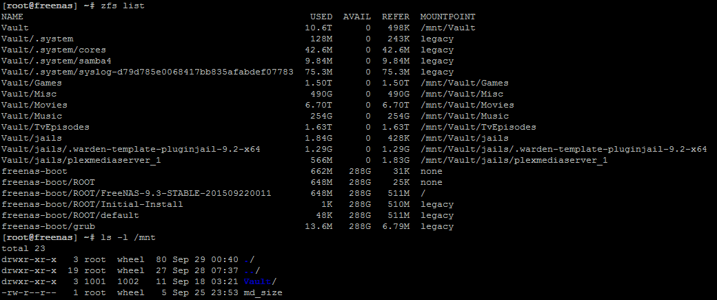

Also there isn't anything in your logs. Just boot logs. What does zfs list, ls -l /mnt and zpool status show you?

Is the problem that the pool is completely full? As I understand it, 9.3 is more conservative and requires slightly more working space on a nearly full pool than did 9.2. That might be why it won't import properly. There are ways of deleting a (expendable) large file from the CLI to regain space for further file operations. I am not sure what would be a good search string for the forum search, but others may remember.
cyberjock
Inactive Account
Mar 25, 2012
19,525
That would be precisely why you are having problems. 0 bytes of free space is bad!

Ok thanks! Now at least I know what the problem is.
If there is a way, as rogerh mentioned, of removing data then the entire /vault/misc/ mountpoint can go.
That would remove 490GB, might that be enough?
cyberjock
Inactive Account
Mar 25, 2012
19,525
Well, you need to fee up at least 100MB or so before you can do anything with mountpoints, datasets, etc.
So first you need to delete something so the zpool isn't locked up like it currently is. ;)
