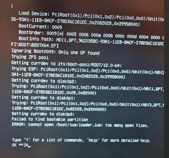

After trivial upgrade from 12.0-U3 to 12.0-U4 our NAS can't start:
ERROR: cannot open /boot/lua/loader.lua: too many open files.
Need urgent help please!

Sorry to mislead you. There was originally one WDC SN730 512 GB NVME as system disk. The picture attached to the first post was on the screen after I gave the command to reboot the updated system.

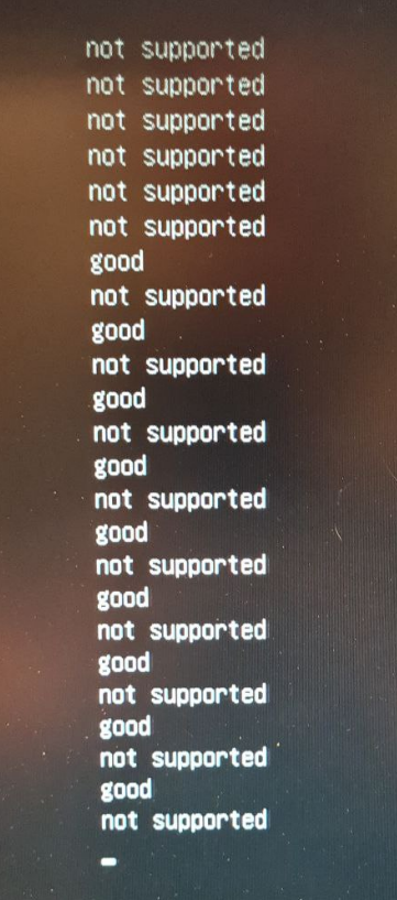

Wondering what is this (can bee seen during boot when the disk enclosure is on):
Jun 2, 2019
590

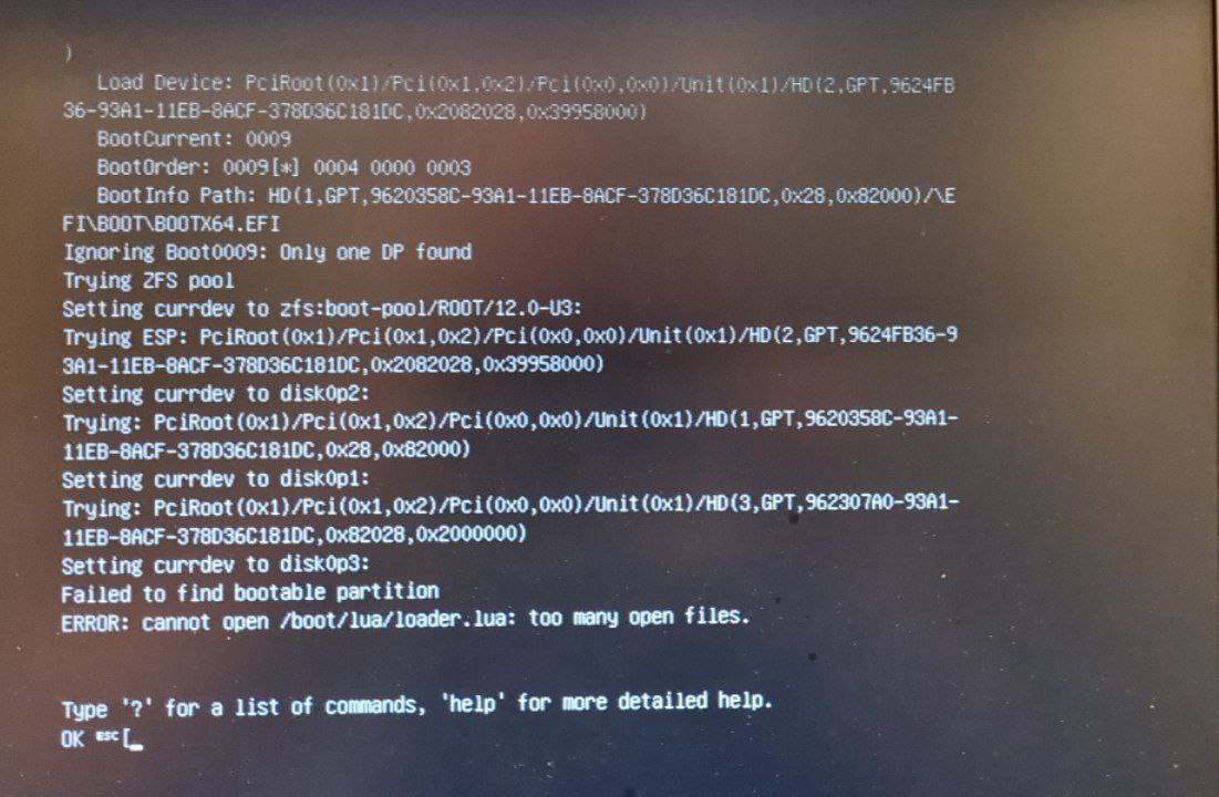

If it can boot with 12.0-U3 and not with 12.0-U4... then there is a bug.
The unusual (less normal) thing about your config is multipath... its not widely used. Has anyone else tested multipath with 12.0-U4?
Rabinovitch
Apr 3, 2021
43
We will try U4 in several hours. I think it will boot successfully. It has already been booted on this version (but I repeat - when the disk shelf is powered off until the bootloader is initialized).
