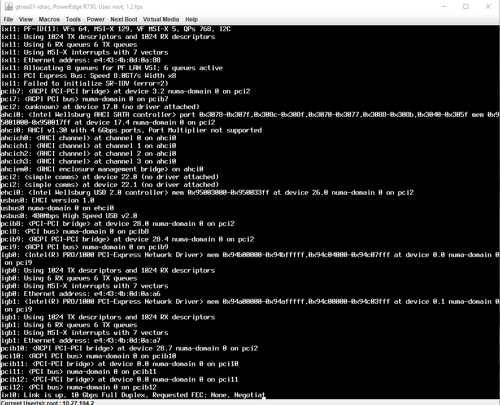

Trying to upgrade from TrueNAS 12.0-U4 to U5 just now locks up after trying to bring up the network interface. See attachment. EFI boot. It's a fairly new install of TrueNAS. I think this might have been the first upgrade of this box. Never had an issue doing FreeNAS/TrueNAS upgrades before. It hangs at this point. I gave it 20 minutes. In the end hand to power cycle and it's come back up on the 12.0-U4 release (and seemingly working fine). Have tried the update twice - same deal both times.
The NIC BTW is a Dell Intel rNDC 2x X710 + 2x I350 combo daughter card. Whether that's the issue or not IDK. Something definitely is borked with this new release.

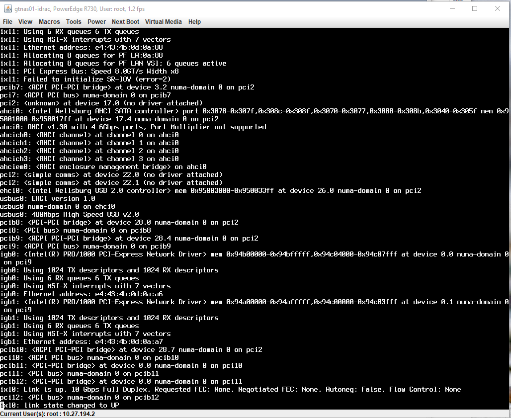

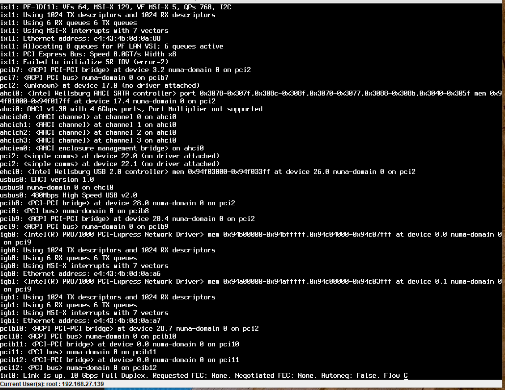

I have more on this unfortunately. I am still getting hangs without the StarTech PEX2M2 in the node! Looks like I fell for "post hoc, ergo propter hoc". Sorry Startech!
What is going on is lock ups immediately after the Intel X710 NIC comes up. ixl0 is the interface - check screenshots.
Two times in a row I booted up and it locked up like this.
The third time, I shut the interface off at the switch, and then it completed bootup. Coincidence?
I did my fresh install of 12.0-U5 and all was fine actually with several boots that completed fine.. But the first boot up I did when I had a VM and two jails sharing ixl0 - that's when I get lock ups.
This is the same experience with the previous build that I had two jails and a VM going fine under 12.0-U4 (or U4.1... not sure what it was exactly) and that was fine but after the upgrade to -U5 I had the lockup issues. Unfortuatnely I stuck that Startech card in the node around the same time as the upgrade, so was incorrectly blaming it.
Wonder if anyone else is having any dramas in 12.0-U5 with the intel X710 and ixl driver? Any changes to that in -U5?! The plot thickens...

I doubt the Intel X710 causes this issue in a normal configuration. It sounds like there is a bug and it might be related to the sharing of the port between VM, Jails and maybe sharing services. Why not turn off the VMs and/or the jails and see if there is a relationship. It could be a FreeBSD networking issue...

I'd loved to have had more time to test but I had to get the box into service Saturday afternoon and ran out of time. I took the X710 daughtercard out and put in another one (unused), and put in a Dell discrete NIC based on Intel X520-DA2, and then my problems went away. Same setup, just different NIC. I'll order a couple more M.2 SSDs for my lab R730 (ESXi host) so I can dual boot into TrueNAS and see if I can replicate the issue.
