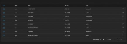

· The 1tb drive, shows up as a 4tb drive.
The pools on the 2tb, 1tb, and 500gb drive, show as detached.
Could anyone explain what happenned, and if there is a fix to this? Importing the pools even with zpool import -f, doesn´t work.

You were absolutelly right. It swems that at startup, the drives peak starting to spin, and then maybe there is not enough current, or who knows, and drives fail to initialize.
I took off the splitters and all drives work when plugged directly.
Sad thing is that I have to find a psu with 10 sata connectors (8 hdd drives + 2 ssd drives).
Im also having now a ton of problems with the drives that failed when everything was plugged, because they got dettached. And when I import the pools back, it gives an I/O error. I tried "zpool import -f" and it also fails to import.

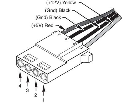

Be specific, what are drive models you have for the ten drives? Why do I ask? Pins 1, 2, and 3 are now 3.3Volt lines and a 4 pin Molex to SATA adapter will not have those 3.3V lines. Most 3.5" hard drives will run fine without those three lines, even most SSD, but some 2.5" laptop drives will only run on 3.3V. While none of this may be impacting you, it's worth looking at to rule it out. If this is the issue, you might be able to move around the SATA power connectors on the splitters to drives that will run fine. Again, this might not be the issue but it should be examined if you think it could be the problem.

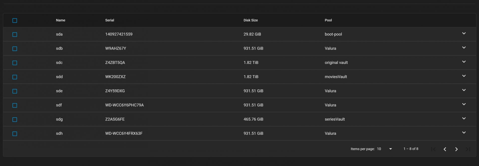

It worked! Thank you!!
The zpool import -FX worked like a charm. I imported one of the 3 faulty drives so far, the 1TB drive. It took about 3 hours to process. After that it showed in datasets but not in storage, and it kept throwing "unable to access group" errors, so I rebooted the system and it dissapeared again. Then I tried to import it again via the GUI and it worked! All files are untouched and accessible, it´s scrubing now.
Also i´m going now for the 2TB drive, that I expect to take 6 hours or so to complete.

They all show that they use 5V and 12V, and noone has 3.3V. So... the splitters should have worked, but as soon as I plug only 1 drive, everything starts to fail.

Well, it ended up being a weak power supply. Even tho its rated at 700W (Mars MP700) somewhy it lacked enough power to spin all disks at once. I guess because it was manufactured around 2014, its very old.
I just bought and installed a second hand Mars Gaming Vulcano 750 W 80 plus Silver Semi Modular, it comes with 7 sata connectors and 4 molex. But you can swap the cables and plug into the 6-pin a cable with 3 sata connectors, so you can end up with 12 SATA. And everything works perfectly now.
All disks spin without a problem. And I still have room for some more.
