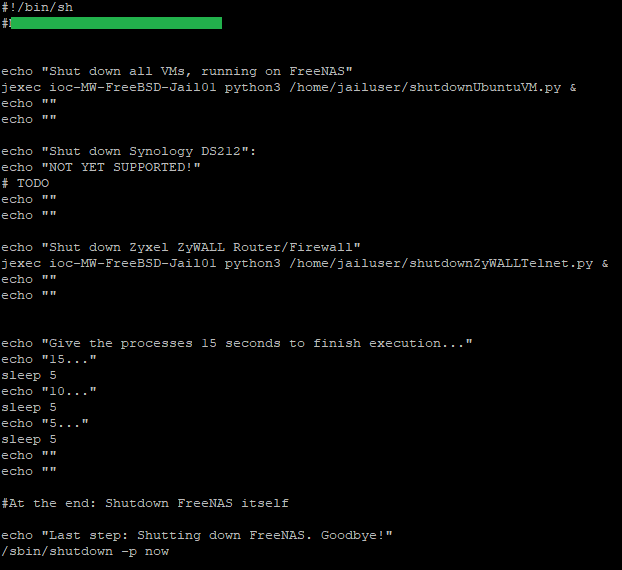

I added a shell script to my FreeNAS shell (I put it to /usr/local/bin/xxx.sh
The shell script consists of:
  • several jexec calls, that execute python scripts in my jail
  • the actual shutdown command for the FreeNAS
I set chmod 777 to the shell script, that all roles are able to execute the command.

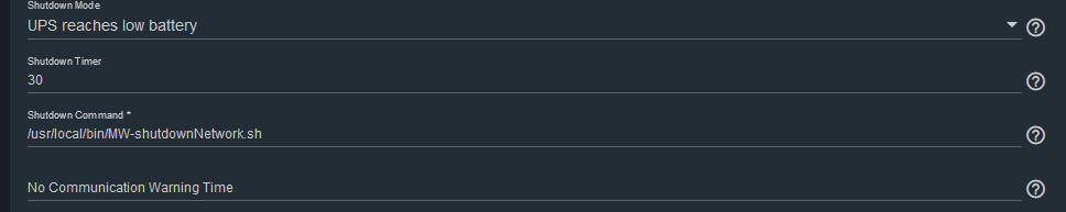

At the end, I replaced the "shutdown -h now" command in the UPS service with this:
Result: Only the FreeNAS server shutdown worked, all other commands aren't executed!

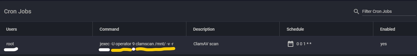

There are essentially 3 sets of permissions that need to be dealt with to successfully set a cron job to run in a jail...

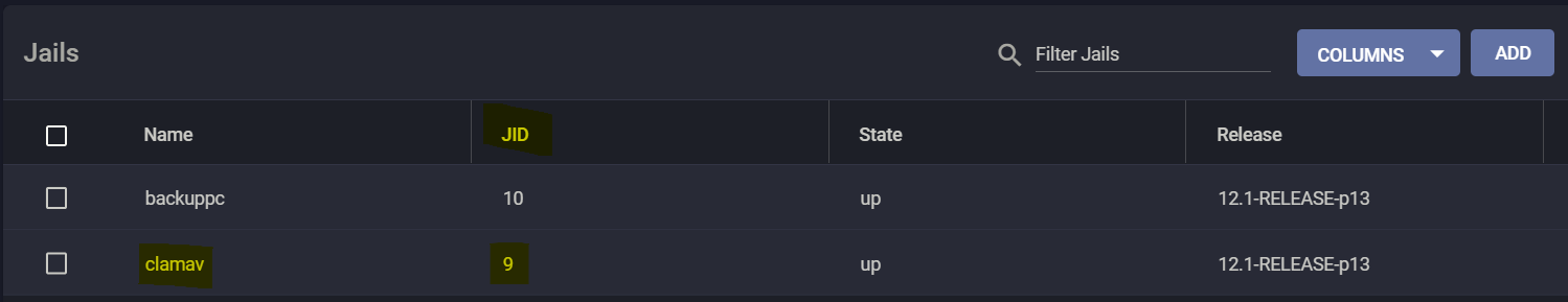

Here is the jail I setup to periodically scan SAMBA shares that are mounted by the jail during startup (note the JID number).
Above is a cron job set to run a clamav scan daily on SAMBA share directories mounted in this particular jail (JID9)
1. Permissions are needed to traverse into and perform work in jails (in my experience this appears limited to root and perhaps the wheel group).
2. Permissions are needed in the jail to run the desired action/executable/script.
3. The desired action/executable/script needs the proper access to perform its intended function (elevation by user or group activation).
(In the above example root runs 'jexec' on jail 9 using the internal user 'operator' to run a recursive clamscan on anything in the 'mnt' subdirectory)
