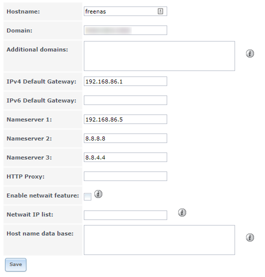

Was recently having DNS issues where nothing could be resolved from the freenas shell. Took a look at the /etc/resolve.conf and this is what shows:
root@freenas:~ # cat /etc/resolv.conf
# Generated by resolvconf
nameserver 192.168.86.2
This seemed odd to me seeing that in the UI it shows:
So I manually entered the values myself in the resolve.conf, and was able to ping and resolve correctly. Rebooted the machine, but the resolve.conf file reverts itself. What's even odder, is that I haven't touched anything in months on Freenas as it had been working smoothly until now. Any advice on this?

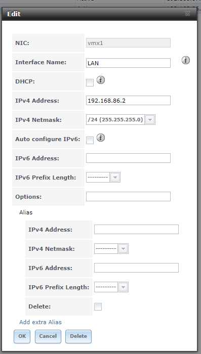

I am wired for a static IP, so perhaps I worded it badly above by saying "pulls". Here is the static assignment from with freenas:

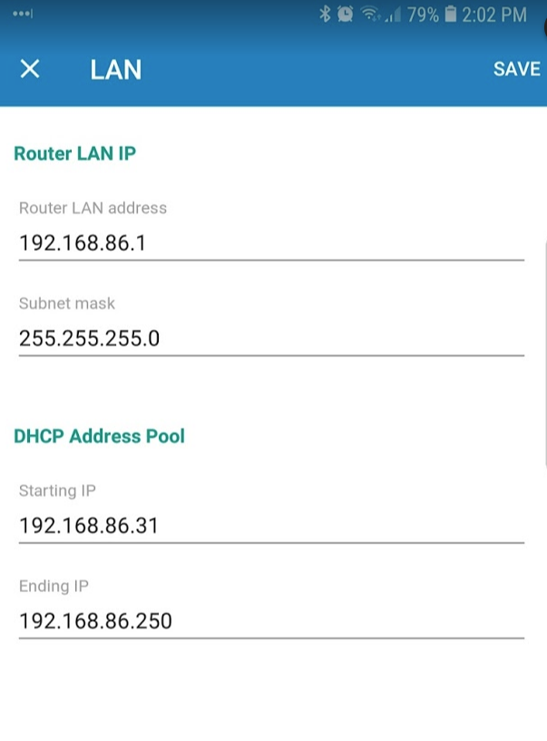

The router is setup for DHCP:
