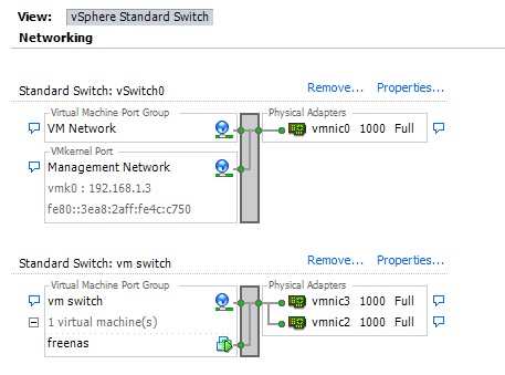

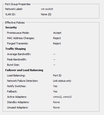

The vswitch in wmswitch is configured as below.
and vm switch as

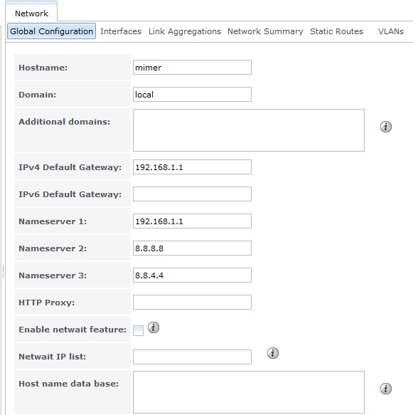

FN is configured as below.

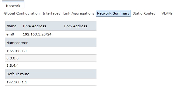

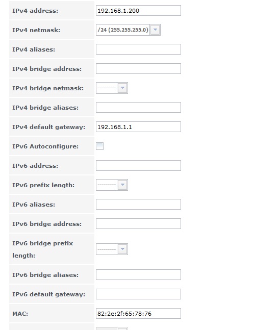

Jail setup.

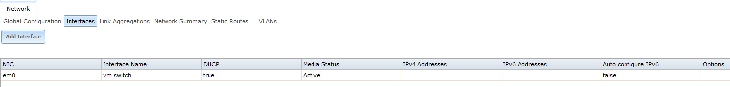

The key here is likely to be promiscuous mode (https://kb.vmware.com/s/article/1004099)...
Jails (plugins) use the same NIC as the FreeNAS install (in most cases), so when each Jail is started, it advertises itself on the same "port" on the switch, but with a different MAC and IP address. This is not allowed by default as it could allow the network to be compromised in many situations (particularly corporate ones... ESX's home territory).
The hardware equivalent would be a server with a single NIC connected to a switch (which by default allows promiscuous mode), so no problems there.

Promiscuous mode is accepted and should be not the problem.
Have I missed something in that setup?

What's the result if you remove the network definition for em0? (I'm not sure it's really needed if you just have a single NIC)
Have you got allow.raw_sockets=true in the jail sysctls config?
I think you may also want to allow MAC address changes and Forged transmits on the switch where you connect the FreeNAS server.
