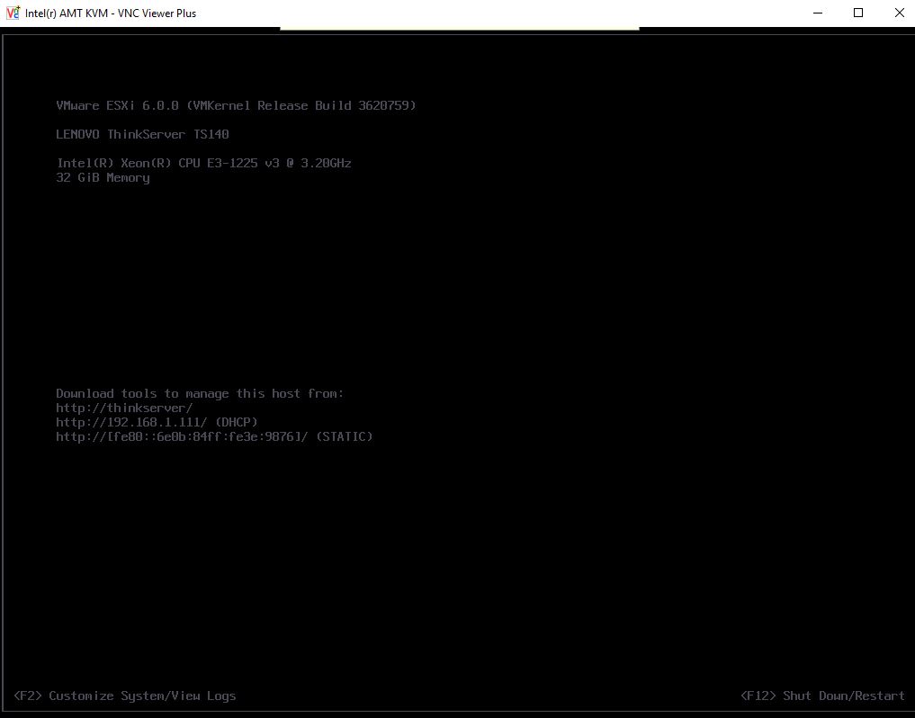

I have ThinkServer TS140 and in it M1015 flashed to IT mode.
I'm following this guide https://b3n.org/freenas-9-3-on-vmware-esxi-6-0-guide/
but it looks like after changing MTU to 9000 and reboot I cannot connect to ESXi via web interface or Windows client?
Its running and I can ping it but can't connect. I already reinstalled ESXi yesterday and today it happened again.
I was under impression that whatever I do to FreeNAS VM it shouldn't have any effect on ESXi.
Any replies are welcome!
Thanks

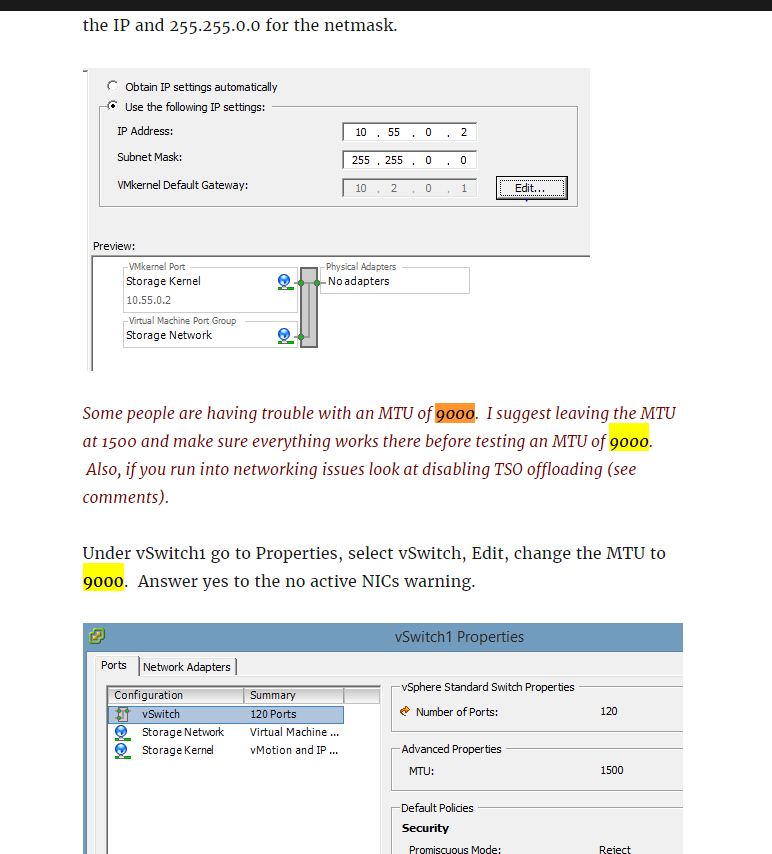

Why not ask the B3n.org group for help? Or vmware? You changed a network setting in a VM and you can no longer access the hypervisor and you come here for help? And furthermore, this mtu 9000 issue looks like it's addressed in the guide you followed. Just search that page for "9000".
I guess I wasn't clear in my question I just needed confirmation that changing something on FreeNAS VM won't have any effect on ESXi. I already posed question couple of days ago on VMware but no reply. Reason for not posting on B3n.org was that I thought its more of a blog than discussion board but that will be next step.

I've narrowed down my issue. After every change I would do a reboot of ESXi and found that after I set private IP (192.168.1.112) here
that is out of DHCP server range after reboot I no longer can connect.
Only if I re-install and check "Obtain IP settings automatically" I can continue without any issue.
What is purpose of this screen does any one knows?
