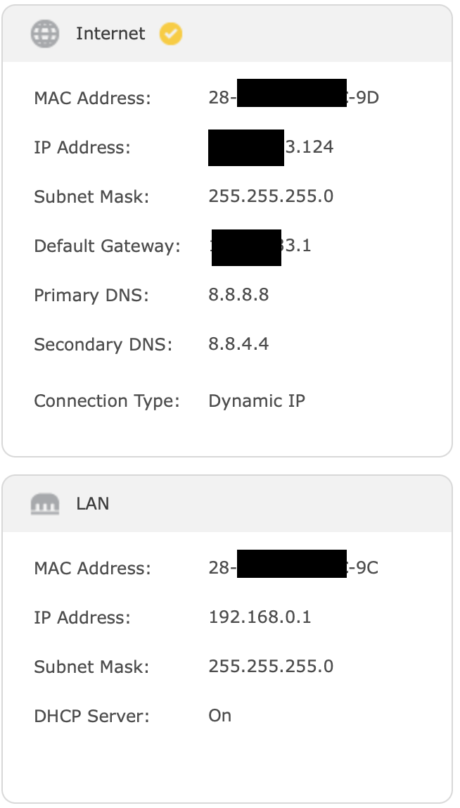

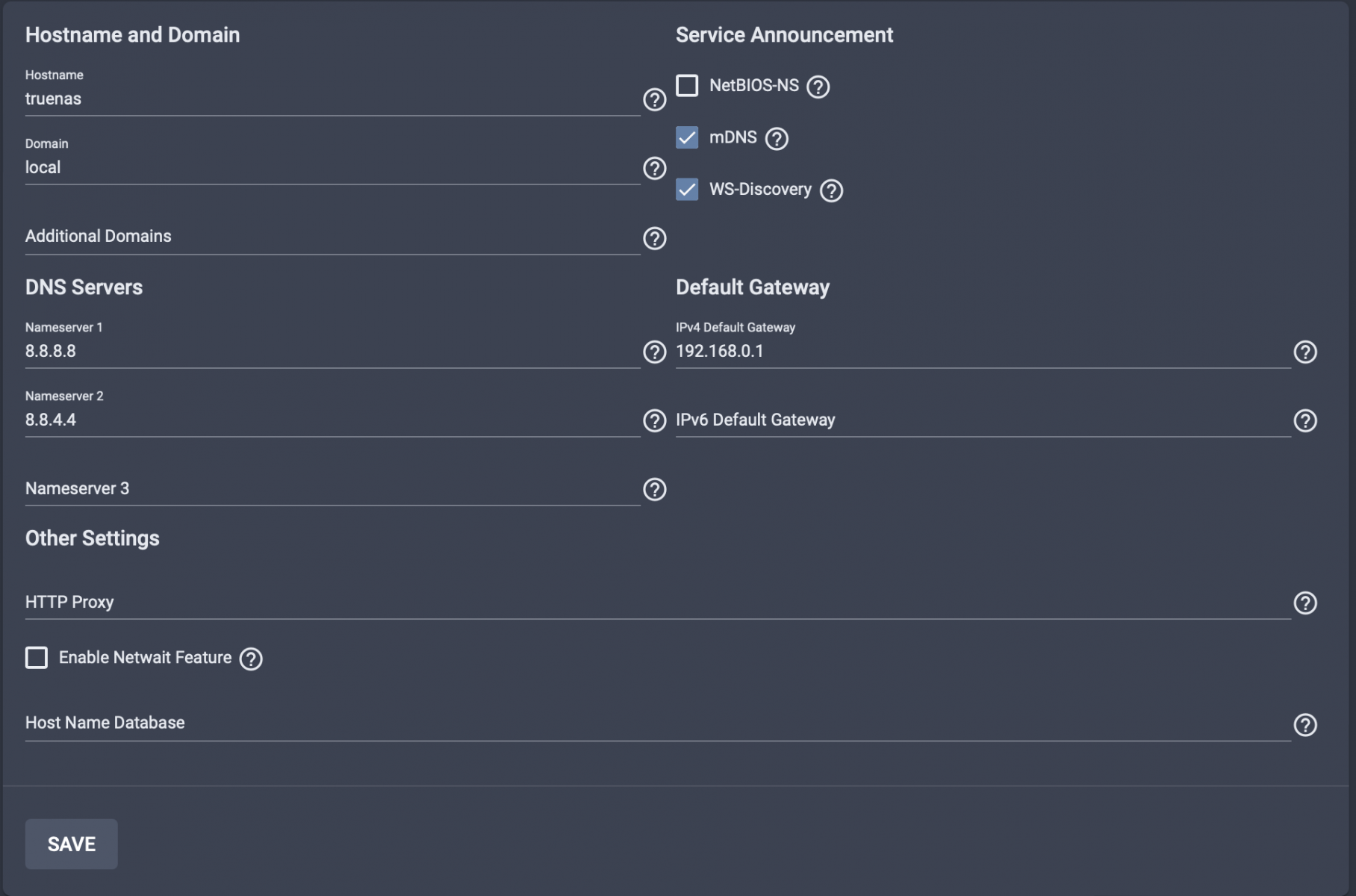

So I have the google dns set on my router, and I have the same set on my truenas
I set the default gateway to the routers IP.
I have an ISP router set to bridge mode, and connected directly with a lan cable to my TP-Link AX50.
TrueNAS 13.0-U2
edit: I have noticed that using websites like "what is my ip" display a different ip from what my router is set to.
I am not using any vpn, and I think that the ISP is using a "double nat". Could this be the core of the problem? if it is, why I do not get any errors elsewhere and only on this (example, Plex updates using the PMS_UPDATE fetched from git, which I used to get network errors for that until I figured out the global network settings stuff).
TrueNAS 13.0-U2
