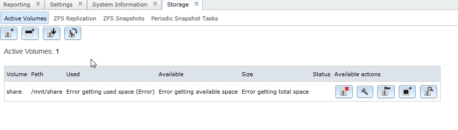

i had to reboot my freenas box and when i tried to access my zfs share, it wasnt available. When i opened the GUI i saw this error:
share /mnt/share Error getting used space (Error) Error getting available space Error getting total space

This can happen when your database gets out of sync with your pool for some reason.
How do you have ZFS setup, as a mirror or raidz?
What version are you using 8.0 or 8.01beta?
You can try from the command line to do a 'zpool export your-pool'
and then from the GUI do Storage -> Volumes -> Auto Import (the Auto Import can be in a slighty different spot depending on which version you are using)
If that fails, do the 'zpool export your-pool' from the command line again
Save your settings
Do a factory reset
After it reboots, try doing the Auto Import from the GUI again
If that works you can try restoring your settings or if that messes things up again, repeat the whole procedure but this time don't restore your settings and re-enter them by hand.
I'm not exactly sure what causes this problem, but see if those steps get your system going again.
