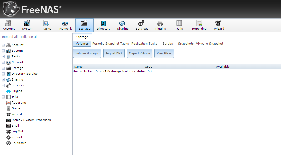

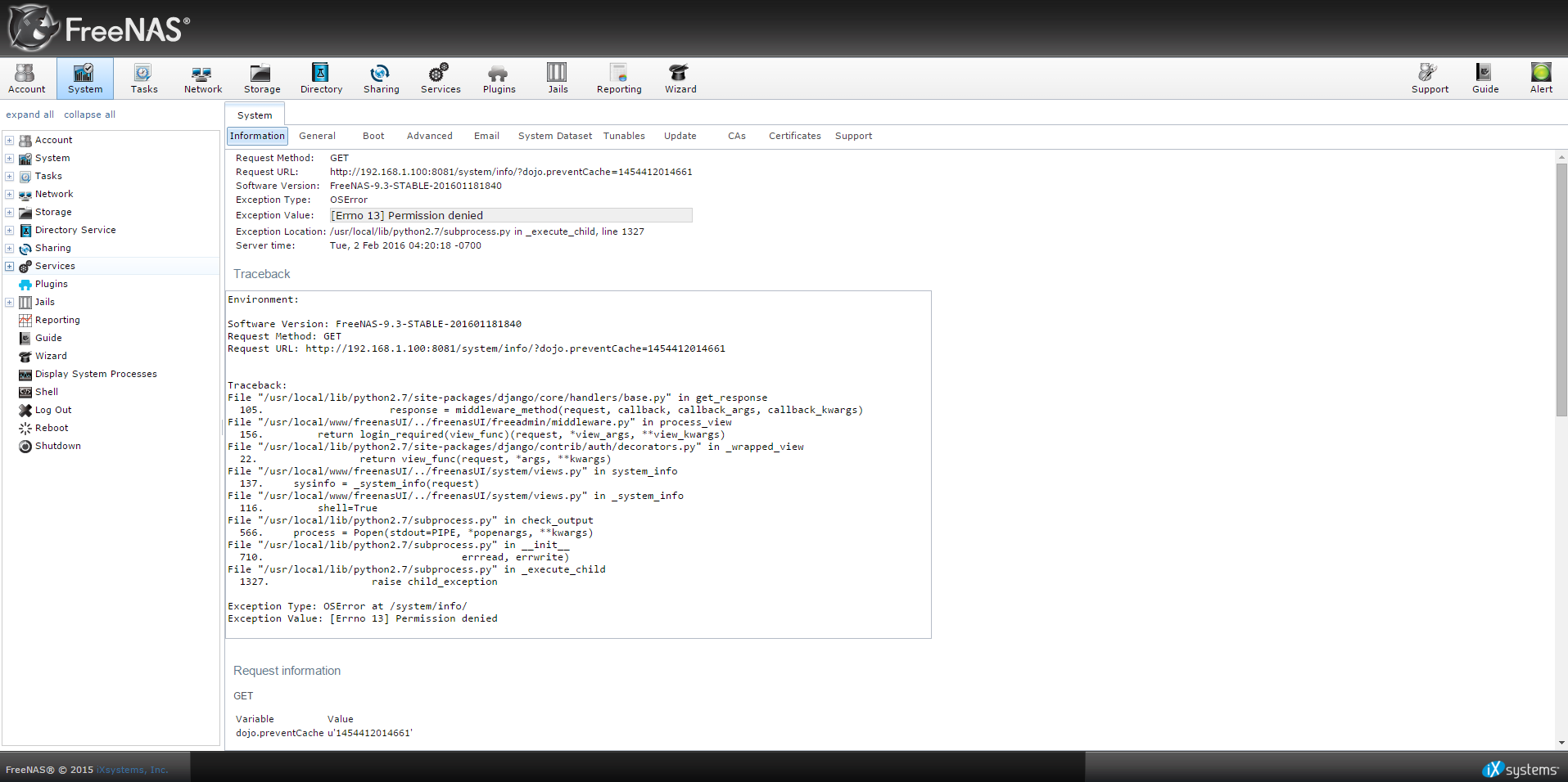

Hey Guys,
Made a terrible mistake earlier, while I was adjusting permissions on owncloud jail I was frustrated and made the permissions to be nogroup and nobody, also made it so there was a black box in each of the permissions below as to not change the octet of permission.

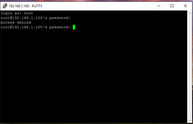

After doing this I was unable to access owncloud, I changed the permissions back on the jail to be root and wheel but now I cannot access most administrative functions including SFTP. Most pages in the admin ui are error pages now, images below.
Is there anything I can do to reset my permissions to a known state? I cannot login with Winscp now as root, it seems to think my password has changed, gives the error access denied and asks again. I also tried to add new user, but this fails with error "[Errno 13] Permission denied"
Any and all help is appreciated, thank you!

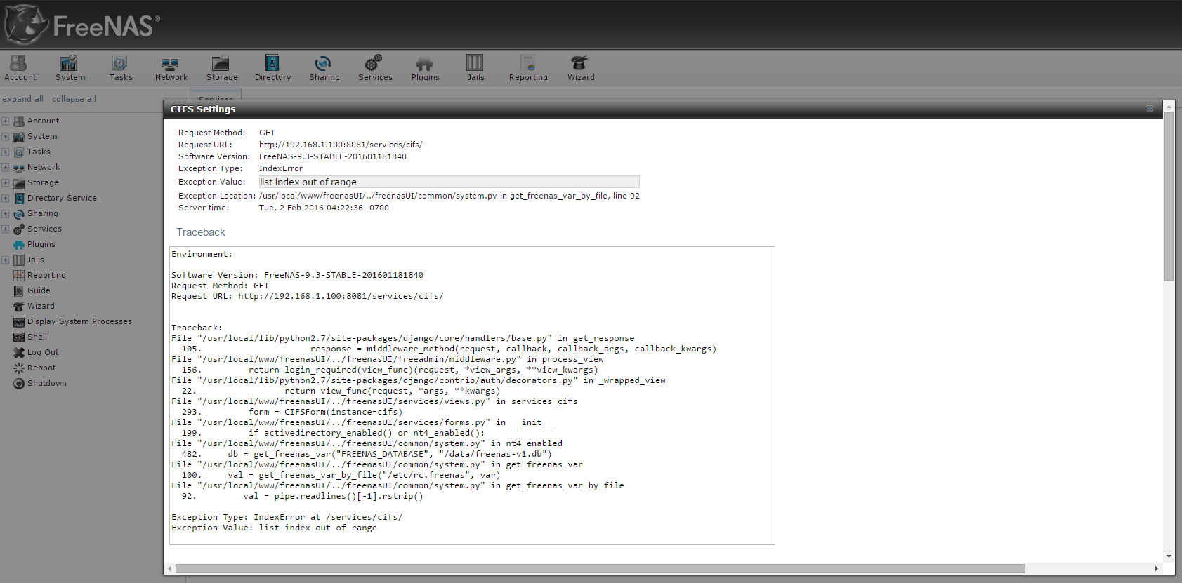

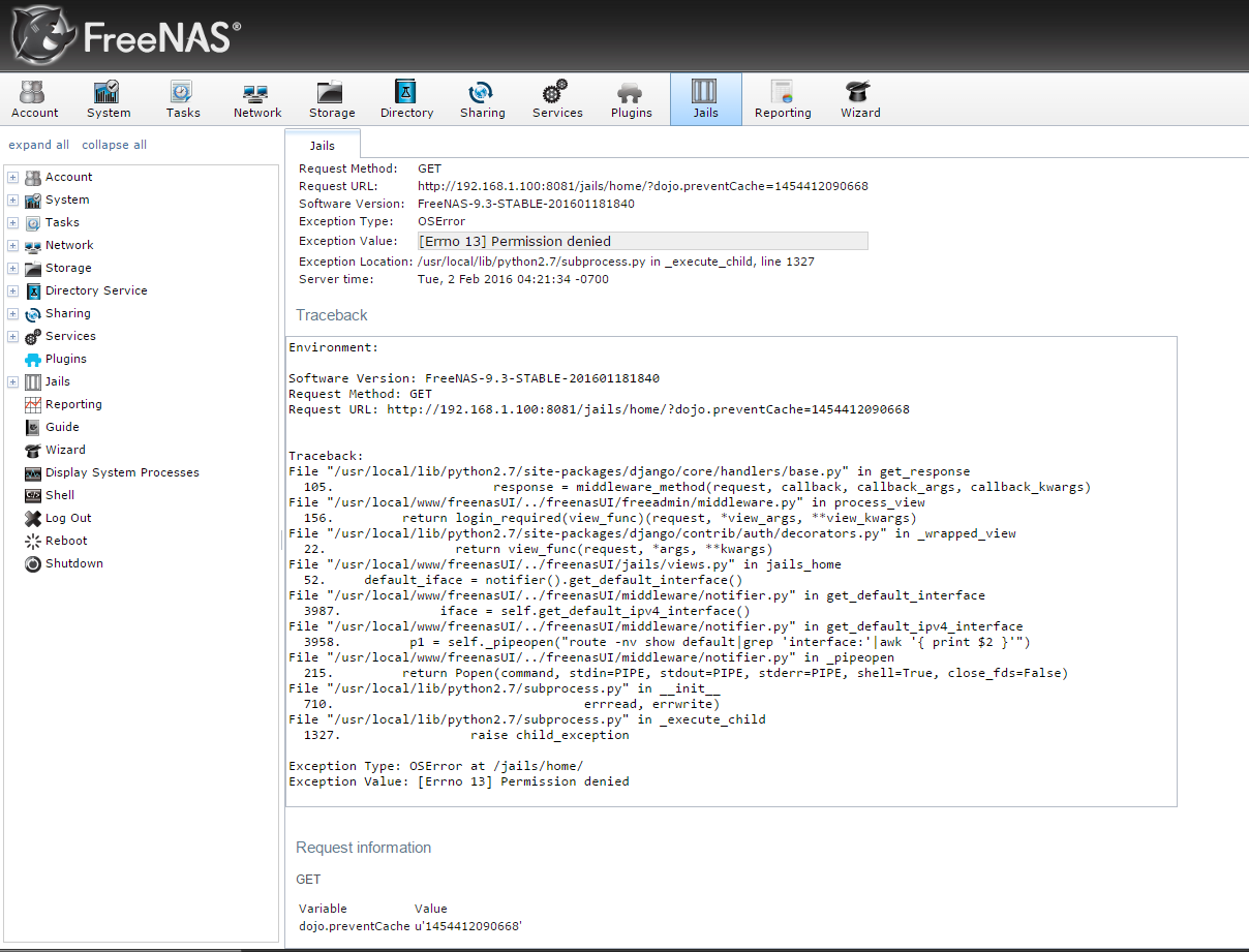

Hey Guys thank you so much for the help! I may not have been clear enough in my haste to post the information I have.
If you take a look at the screens above I cannot login to SSH as root or anybody, Freenas thinks my password has changed but I can still login to my web UI with it(this proves it hasn't). Once in the Freenas web ui, it is extremely broken, screens on first post, most pages do not work and yield error messages. I tried to add a user to Freenas and I cannot, get permissions error. Cannot edit password for root as I get a permissions error on applying the setting. Cannot restore to a snapshot, different error, image above. Cannot adjust system settings, permissions error.
Seems I have hosed my setup completely, I cannot get to any administrative settings. On the bright side my CIFS share is still working(tried to adjust permissions on it, got a permissions error, image above). I can provide access to the box if anyone wants to play with fire.
