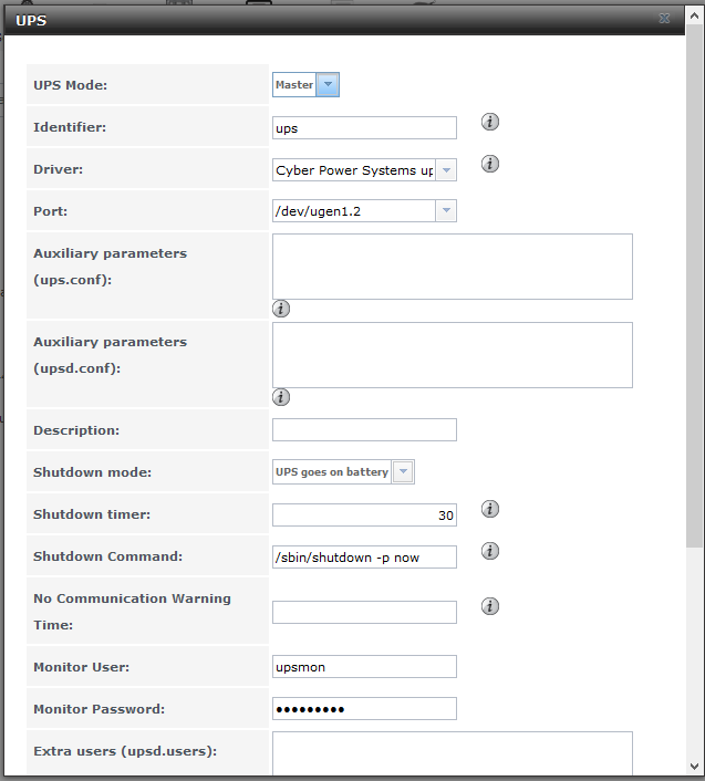

But my issue with the connection for new UPS is when I test access, I get the return: "connection refused" - which obviously means I don't have it 'pointed' to that port correctly.
But I've definitely determined it is plugged into USB 1 (ugen1.2) because after I performed:
[root@****** ~]# dmesg | grep ugen
I get:
uhub3: ugen0.1: <Intel UHCI root HUB> at usbus0
ugen1.1: <Intel UHCI root HUB> at usbus1
ugen1.2: <CPS CP1500PFCLCD> at usbus1
And yet I THINK I've got this setup properly in UPS service:

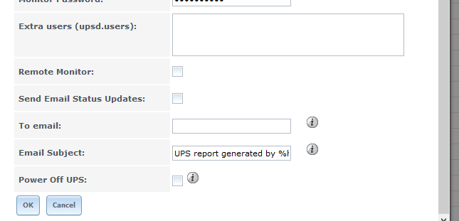

And correct me if I'm wrong, but the monitor password should altered from the default (fixmepass) to root PW - right? Which is what I did ...
but when I do: uspc ups
I get:
[root@r******* ~]# upsc ups
Error: Connection failure: Connection refused
And I've tried a LOT of the drivers that appear to be for similar Cyberpower UPSs, but get the same results, so I'm not doing something right, no doubt.. or maybe 'left something out' somewhere... And of course my Freenas / Linux "guru" is in California for the week and won't answer his @#$#%$ phone.. (NOT that I blame him)
Hints?

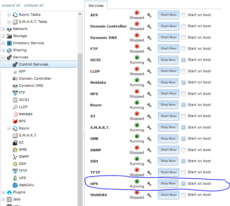

Did you turn the service on?
Redcoat
Feb 18, 2014
2,925
I have the same UPS. Only difference for me is that I have always understood that the pw should indeed be "fixmepass" and that's what mine is. And mine does work.
To determine the port setting, I used the technique described in the manual :"For USB devices, the easiest way to determine the correct device name is to check the box Show console messages in System →Advanced. Plug in the USB device and look for a /dev/ugen or /dev/uhid device name in the console messages." - it does not indicate the same apparent result as the method you used for my install. However, I have also heard that it doesn't matter what value you select for that box, all should work... but I never tested that suggestion.
Chris Moore
May 2, 2015
10,079
The username and password is all about another system being able to get the UPS status of your UPS via a network connection to this server.
If you change the port setting in your UPS to something wrong, you will get this error in your log:

The gist of that is, you are telling the system what USB port to look at to get updates from the UPS and if you are looking at the wrong port, the data from the UPS is, "stale"...
When you have the UPS monitor pointed at the correct port, your log will update, like this:

Oh for ... Jeez.. uh.. heh yeah, ya dipsoid.. Ya gotta turn it on for cryin' out loud.. Isn't that amazing
Heh-heh.. Cripes... guess it works when UPS service is 'on'...
I'll be alright in the morning, I know it...
I'll be all right in the morning, I know it...
I guess that means it is working now? ;)
