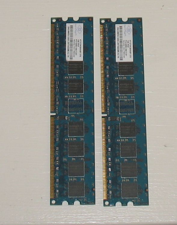

So what's the difference between ECC and non-ECC RAM physically/electrically? Literally, you have 8 more bits. Typically, RAM has 2, 4, or 8 chips on it. In the case of 2 or 4 there will be a smaller extra chip that handles the extra 8 bits. But for 8 chip RAM sticks, some are special. Some manufacturers make only ECC PCBs. This helps with production costs as they have to make only 1 PCB to cover their entire line. Then, when they decide to make a RAM sick they decide to either go with 8 chips(non-ECC RAM) or 9 chips(ECC RAM). All of the chips are identical in 8 bit increments(8bits per chip * 8 chips= 64 bits; 8 bits per chip * 9 chips = 72 bits). That's it! (Don't confuse this with registered RAM that has to mitigate capacitance from high density RAM). Here's a picture comparing ECC and non-ECC RAM. Notice the number of chips.
Check out the below picture:
See the white square? That's where the 9th memory chip would go. So I know without looking up this RAM model it is definitely non-ECC RAM. ECC RAM will always have 3, 5 or 9 ram chips(basically odd number of chips). But don't confuse the ram chips with the registered RAM as those have extra chips to deal with capacitance from high density DIMMs.

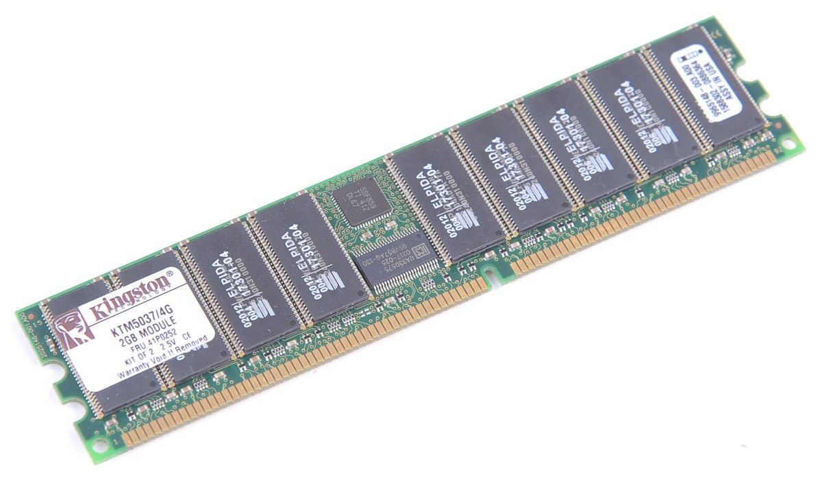

Notice the 9 chips(so this is ECC RAM) but see the 2 smaller chips in the middle. That's your giveaway that this is Registered RAM.

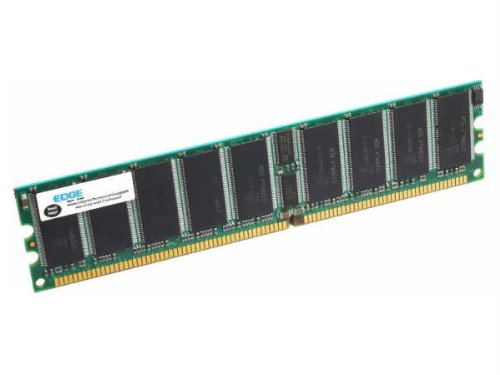

So lets apply this new found knowledge... Go to this Amazon page and look at that. It's ECC RAM, but has only 8 chips. The seller is selling it as ECC Registered RAM. Guess what? You and I both know that the picture is not of ECC RAM nor is it registered.
Check out this Kingston RAM. One picture shows what is definitely ECC + Registered RAM, but the other picture is clearly non-ECC unregistered RAM. Again, our secret...
Here's a test. Look at this stick...is it ECC and is it registered? Look up the model number on Kingston's website for the answer...
So now, at a glance, you can look at a stick of RAM and without even looking up the model you should be able to identify ECC from non-ECC and registered from non-registered.
