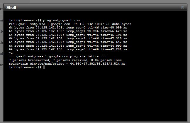

Thnak you for quick reply.
I did read that thread, my settings are exactly the same and I still coud not send test email.
I tried both port numbers it did not make difference. The question is why ping within the shell
resolves url correctly and emil setup does not? Do I really have DNS problem or there is a bug in FreeNAS?
I attched a screen capture of the ping.

If you change back to smtp.gmail.com does the email stop working?
Gasha
Nov 10, 2012
18
Damn! It does work now even with "smtp.gmail.com". Anyway, thank you for you help, I appreciate it.
