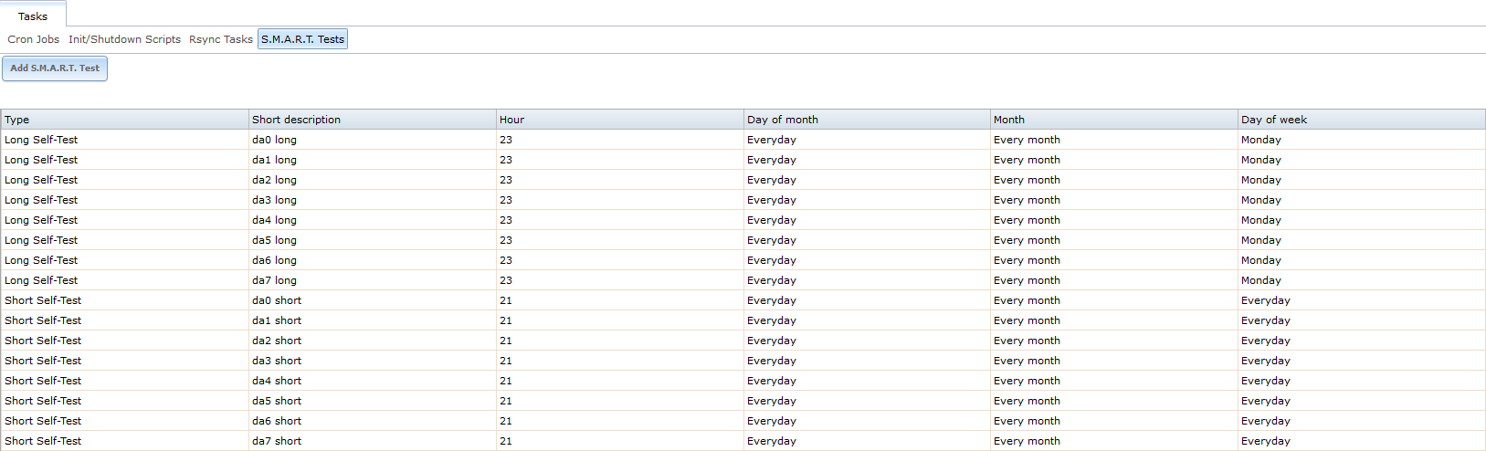

So been waiting for the last couple of days for long tests to run, however for some reason there not running even though I scheduled them. I set them to run at 11 pm for the last couple of nights but they haven't run, the short tests run fine every day though. Posted a pic of my S.M.A.R.T. tasks tab to see if I screwed up anything.
Also 2 quick questions
1. I was told recently that I need to keep half my pool free for cron jobs etc, is that true? my setup is 8 4TB drives in RAIDz2 on one pool so... heaps of storage and heaps unusable if that is true.
2. Is there a way to see current running S.M.A.R.T. jobs?
Thanks

15,504
Not even close to true. Either someone's very badly misinformed, or you're very badly misunderstanding what they're saying.
Edit: I don't see anything wrong, as such, with your SMART test setup, but it's much more complicated than it needs to be. A single entry for the short tests on all drives, and a second entry for the long tests on all the drives, is all you need. No need to have a separate entry for each drive.
Edit 2: Just kick off the SMART tests at the CLI for now. smartctl -t long /dev/da0, repeat for each drive. After whenever it tells you to expect the test to be done, check the results with smartctl -a /dev/da0 (and again, repeat for each drive).
Oh, didn't realise you could select all drives at once, my bad :oops:.
Ah ok, I'll do that in a bit. I've got emails set up now to so I should get them hopefully.
