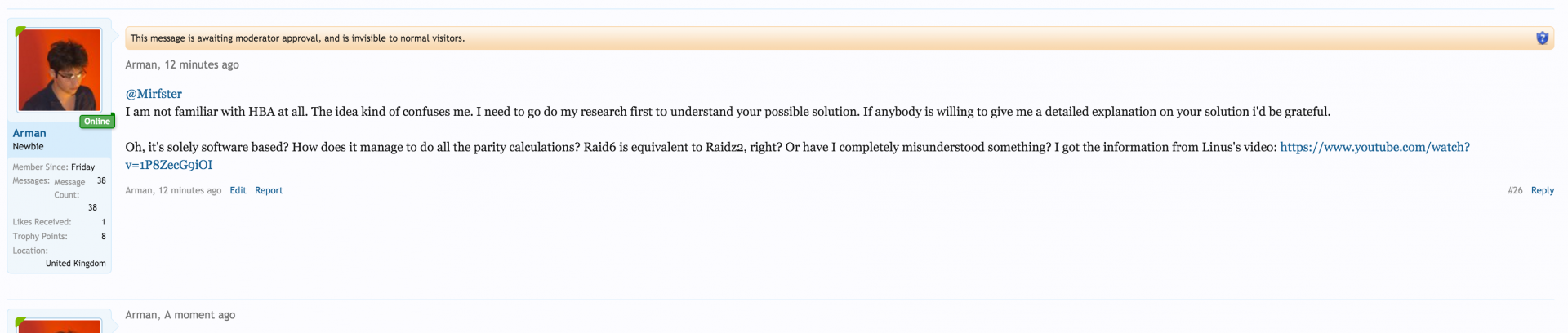

I am not familiar with HBA at all. The idea kind of confuses me. I need to go do my research first t0 understand your possible solution. If anybody is willing to give me a detailed explanation on your solution i'd be grateful.
Oh, it's solely software based? How does it manage to do all the parity calculations? Raid6 is equivalent to Raidz2, right? Or have I completely misunderstood something? I got the information from Linus's video: https://www.youtube.com/watch?v=1P8ZecG9iOI

I don't know why my message is waiting for moderator approval... But anyway, here it is unless you don't see it on time. @Mirfster
