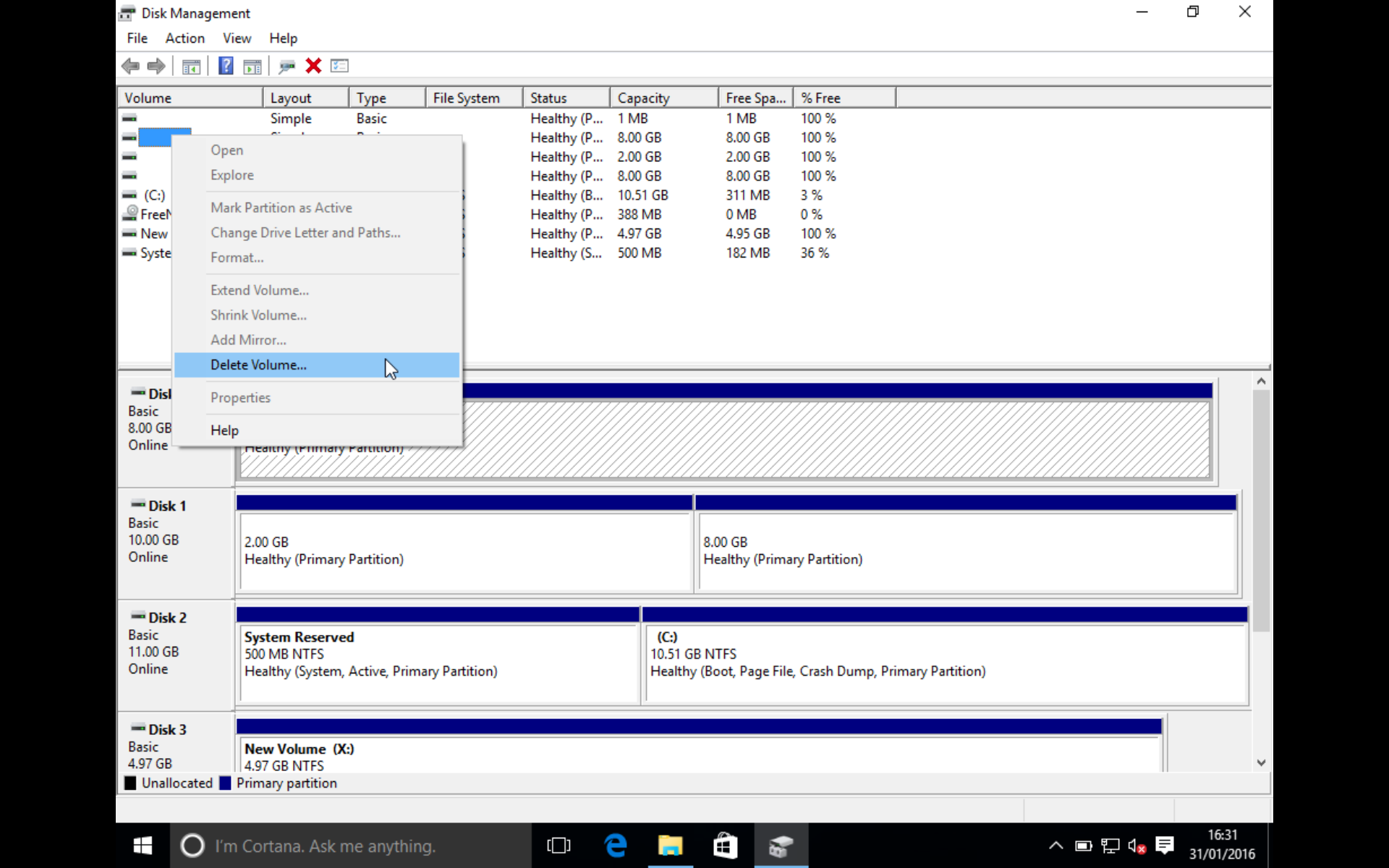

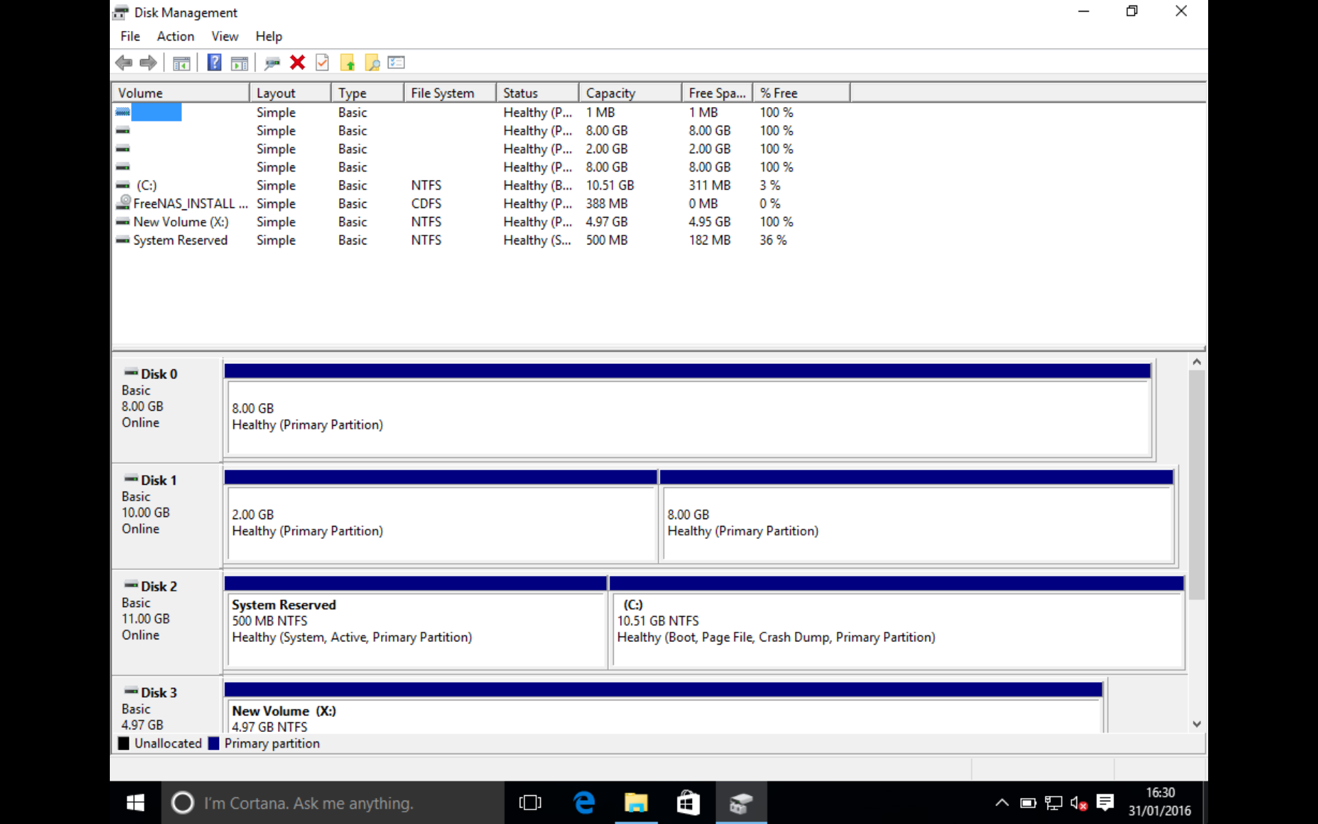

(This is windows 10 running on Parallels 11 just so I can test my idea) (I manually inserted the windows 10 .hdd file into the freenas virtual machine.)
Do you agree?
Yes I understand that this is not the way freenas is meant to be used but it seems safe enough! Unless I go and wreck the drives manually (which I could do from the freenas anyway...) . That's the only way it could happen from windows, right?
This idea came to my mind when I seen unRaid claiming you could run a NAS and at the same time use the computer to play games. I got jealous and thought why couldn't I do something similar with freenas? I will not choose unRaid because it does not use ZFS as its file system and doesn't seem as reliable as freenas...
Could you get more people to take a look at this thread and verify what i'm planning doing here is not catastrophic? I'll be very grateful!!

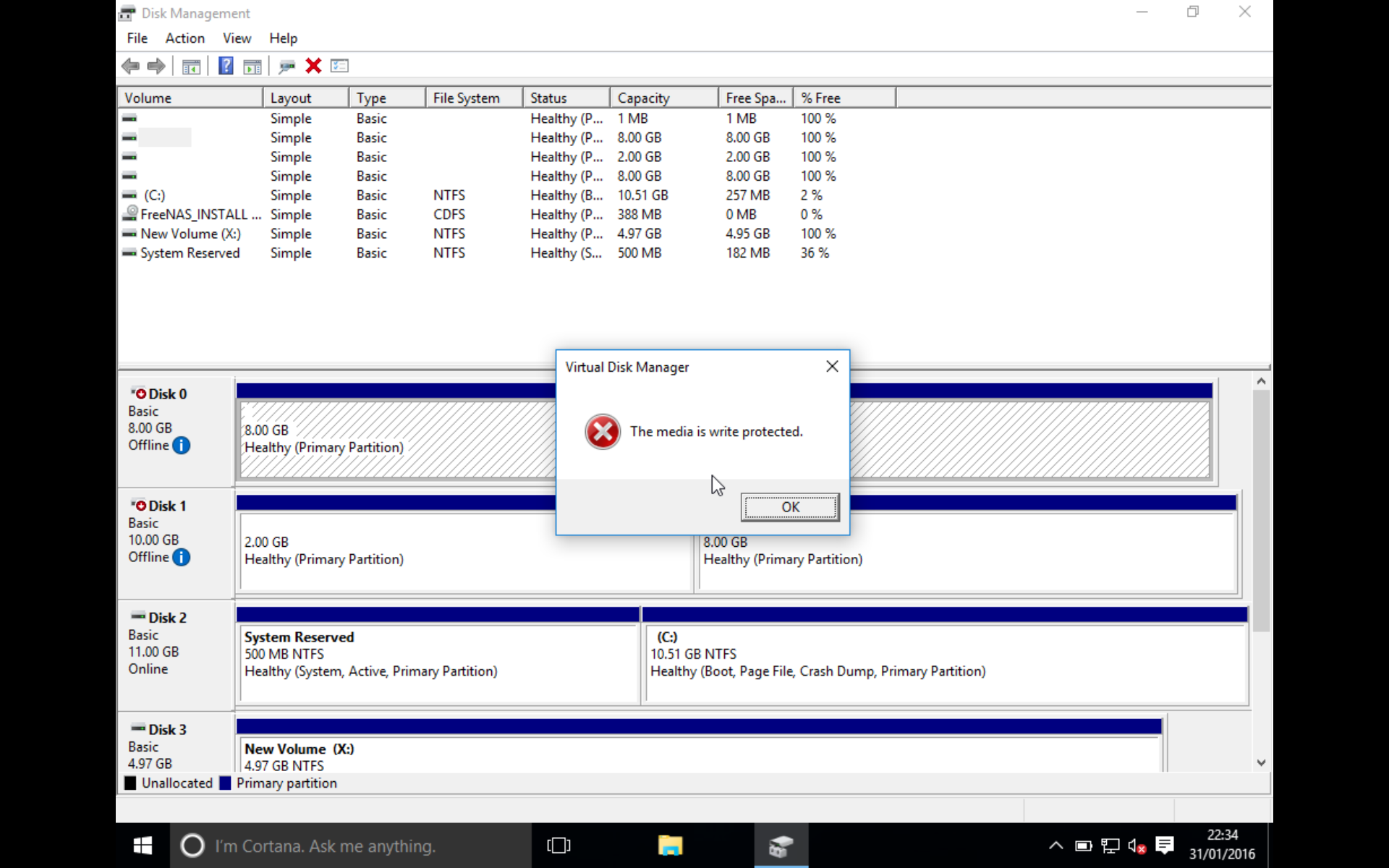

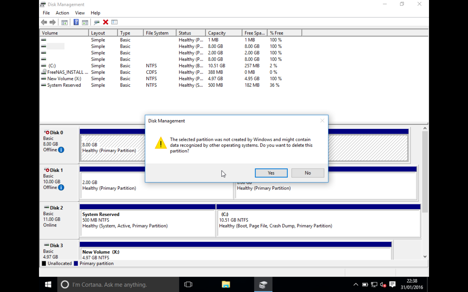

UPDATE!! I actually tried to delete a freenas volume after I backed up the .hdd file and this is what I got!! :DD All I need to do set the drive to offline in disk management! However after I set the device back to online and tried to delete it it got deleted.
