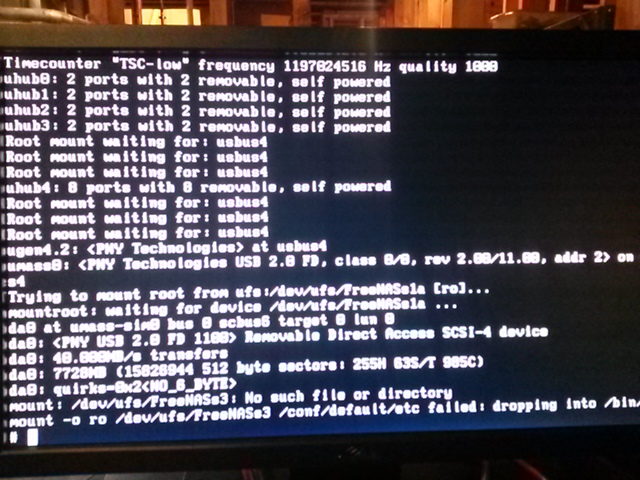

Hello All,
After installing 9.2 fresh download from a CD to USB drive and booting to the USB drive I get:
(last two lines)
da0: quirks=0x2<no_6_byte>
dropping to /bin/sh
So it does not boot to the OS.
It's a SuperMicro PDSMU MB
What can I look for?
TIA,
~eric

Sorry, the next to last line is actually:
mount: /dev/ufs/FreeNASs3: No such file or directory
The installer must be failing to setup this mount.

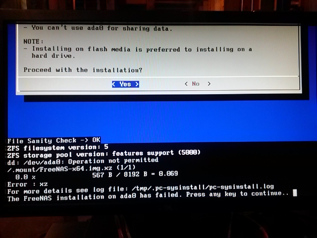

So just now I attempted to install to a local disk. I tried four different disks. It would not install with the following error:
Hmm, that is strange.

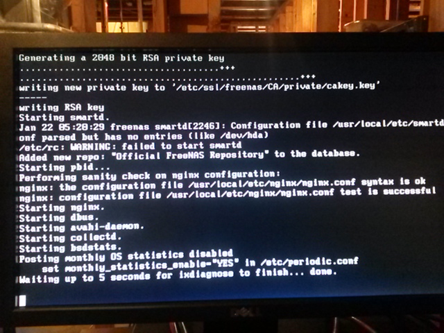

So I downloaded the img file and burned it directly to the flash drive.
It booted but stopped at:
To make sure that the img file was not corrupted I grabbed a Dell Precision 490 Workstation and loaded the USB imaged drive on it.
It booted up properly and presented me with a web page.
So I am beginning to think that FreeNAS does not like PDSMU!
