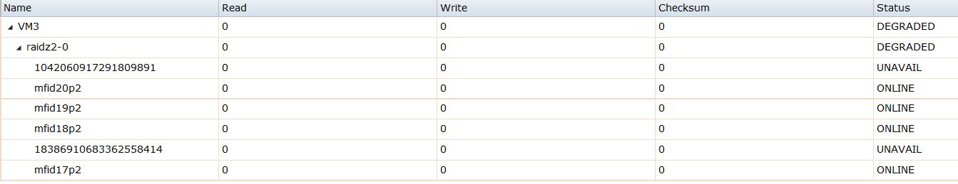

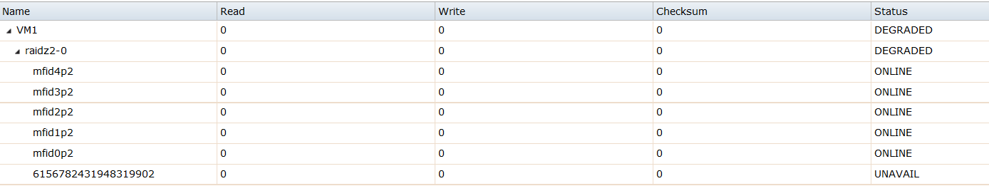

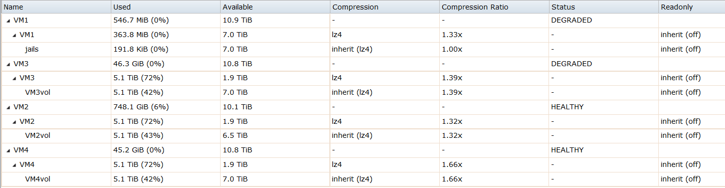

I've run into a situation where within 2 pools a few drives have become unavailable:

NAME STATE READ WRITE CKSUM
VM1 DEGRADED 0 0 0
raidz2-0 DEGRADED 0 0 0
6156782431948319902 UNAVAIL 0 0 0 was /dev/gptid/2b9b8cbd-31cf-11e6-9f12-00e0ed313542
gptid/2bc708be-31cf-11e6-9f12-00e0ed313542 ONLINE 0 0 0
gptid/2bf8b9f4-31cf-11e6-9f12-00e0ed313542 ONLINE 0 0 0
gptid/2c25a81a-31cf-11e6-9f12-00e0ed313542 ONLINE 0 0 0
gptid/2c528c71-31cf-11e6-9f12-00e0ed313542 ONLINE 0 0 0
gptid/2c83049b-31cf-11e6-9f12-00e0ed313542 ONLINE 0 0 0
errors: No known data errors
VM3 DEGRADED 0 0 0
gptid/b72520a4-31d3-11e6-be72-00e0ed313542 ONLINE 0 0 0
18386910683362558414 UNAVAIL 0 0 0 was /dev/gptid/b75143d5-31d3-11e6-be72-00e0ed313542
gptid/b7866bdc-31d3-11e6-be72-00e0ed313542 ONLINE 0 0 0
gptid/b7b3de18-31d3-11e6-be72-00e0ed313542 ONLINE 0 0 0
gptid/b7e182ea-31d3-11e6-be72-00e0ed313542 ONLINE 0 0 0
1042060917291809891 UNAVAIL 0 0 0 was /dev/gptid/b816616b-31d3-11e6-be72-00e0ed313542
It appears that the drives in question have been pulled and then possibly replaced...which makes the gui completely useless at this point as the option to offline (not present) and replace (no options in the drop down) irrelevant.
I've gone to the command line and tried the zpool online/import/replace commands to no avail.
Again...I do apologize for the noob question but I'm kind of stuck and could use a hand. Any assistance or guidance would be greatly appreciated.

2. Did a Scrub of each pool - VM1 and VM3
3. Rebooted the system
4. Came back in the same state as before
