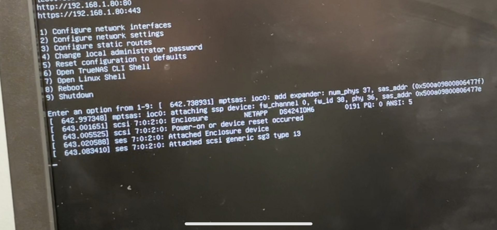

I have a drive in a NetApp DS4246 disk shelf connected via a SAS3801E HBA and a QSFP to mini SAS 8088 cable. When I power on the disk shelf I get a message on the screen that it has been detected then it goes away and I don't see the disk showing up in the web UI. I am running the latest version on Truenas Scale that I just installed.

I looked through that, did not find anything that helped me, I believe I have everything hooked up as suggested, I have tried moving the cables to different ports but not change. Here is what I see when I power up the shelf, after this is just reloads the standard options

With NetApps, you have to do a bunch of configuration on the shelf itself to present disks to external controllers, using the ONTAP CLI interface on the shelf itself. TrueNAS doesn't see any disks because the shelf isn't configured to do so. The shelf also has to be cabled correctly.
