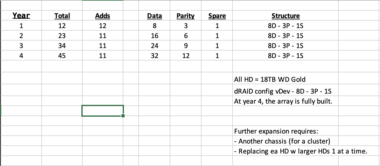

Am I wrong in believing you can use dRAID now?
Unfortunately, yes. dRAID won't be available until OpenZFS 2.1, which won't arrive until TrueNAS 13.
TrumanHW
Apr 17, 2018
197
Afaik ZFS cannot expand draid vdevs, and the upcoming raidz expansion feature could be adapted to also work on draid, but hasn’t been.
With current tech, your best bet is multiple raidz3 vdevs, one per year. The drawback is the longer rebuild time compared to draid.
And, if any of stripe (assuming he's not just adding mirrors) fail, all data is contingent on recovery of a single stripe. Whereas dRAID's resilience always increases & recovery-speed scales as devs increase, expanding via RAIDz stripes increases the odds. Of course 3 Parity devs is good, but a RAIDz3 been lost before.
I tried making his layout nice(r) to look at & made a Tab Delimited TXT File.
  • dRAID - 8-3-1.txt
