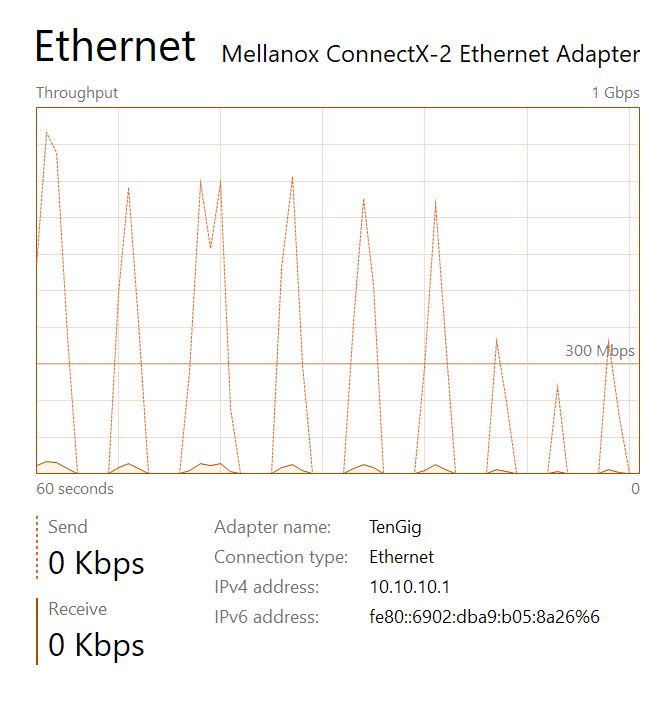

Hello guys,
I recently updated to Freenas 11.2 U6 and installed the Plex app afterwards, since it didn't work after the update. I also defined the nameserver and the gateway so that I could access the Plex server via the web browser.
Shortly after I recognized, that my upload speed to the windows shares of ther sever where super slow and I had a look at the task manager: the connection consists of spices only (see attached image), which go up to about 1 Gbps and down to 0 - the average write speed is about 10 Mbps.
Still, my download speed seems to be stable at high speeds (about 280MB/s, limited by my Windows SSD).
Berforehand I didn't have any trouble with speed whatsoever, write speeds even where as high as 500MB/s. And the issue isn't only from one computer, but also from my other devices - so I assume the issue lies in my server.
Also, if I copy a file from one share to another, the speed is also very high (about 350 MB/s), so it has to do with my network configuration I guess.
I would be super thankful if you guys could help me out. If you need more informations, I'll be happy to proved as much as I can!

It might be a routing issue as you have 2 different internal networks defined.

Running a packet sniffer while reproducing the issue should show where the packets are getting slowed down.
