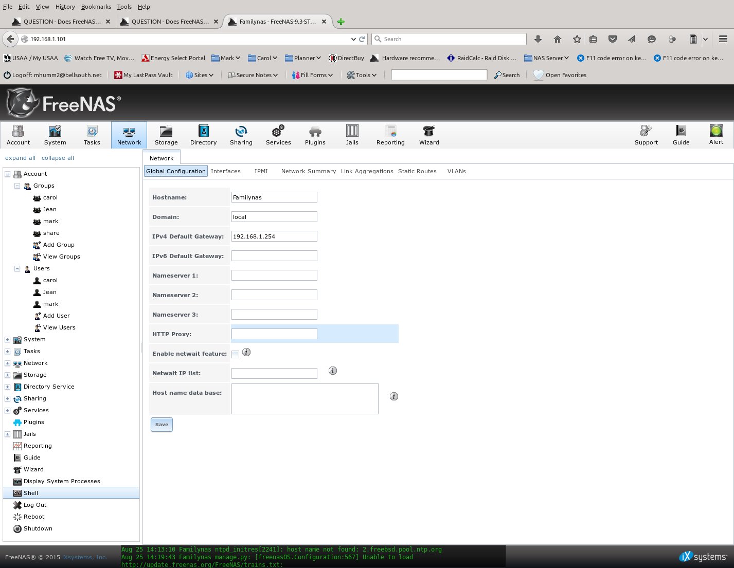

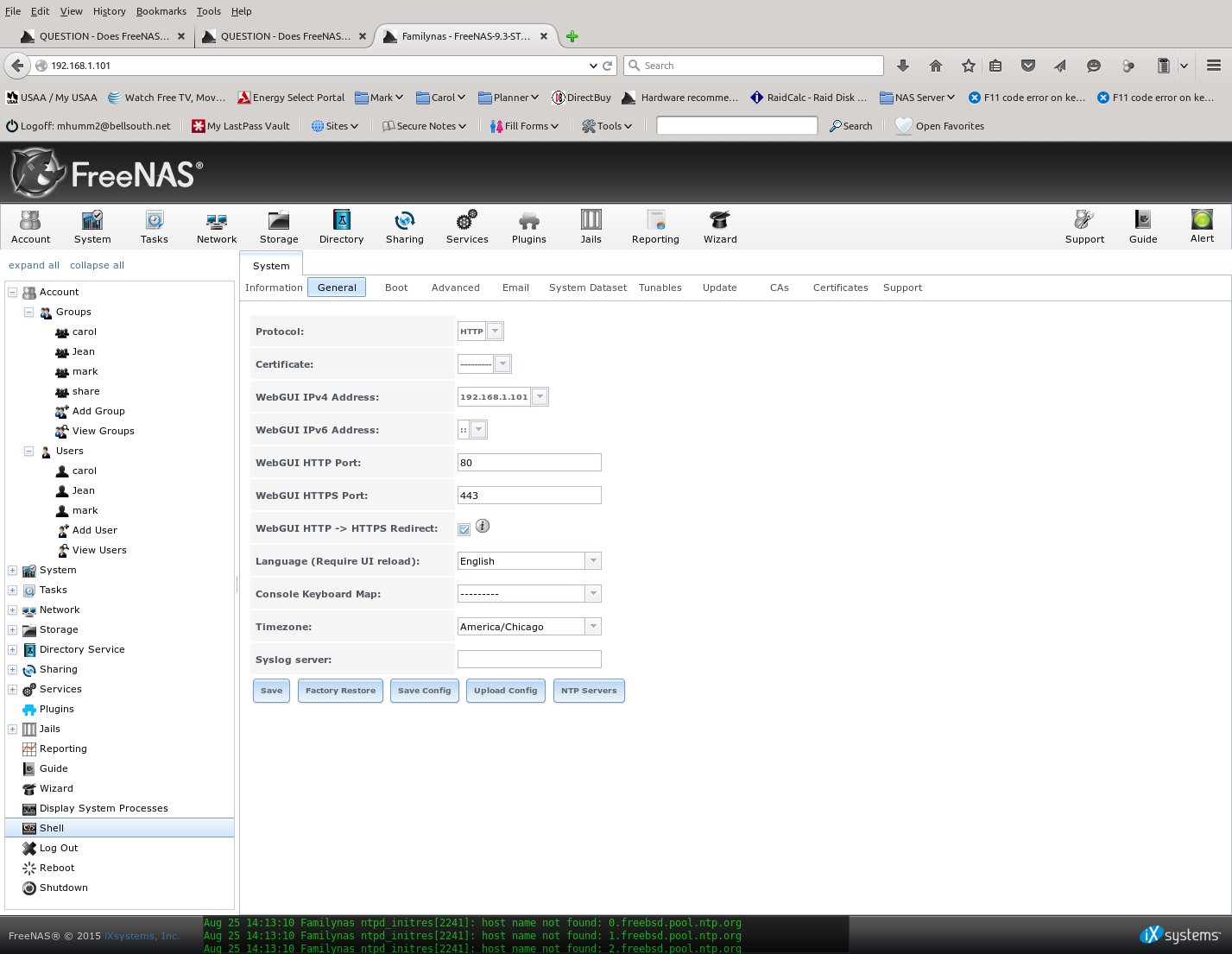

rogerh, I assigned the IP address to my freenas machine making sure that the IP address was in the range of my DHCP. I thought it better to have everything on static IP, but I may not have done that correctly either. My freenas mobo IPMI is on 192.168.1.100, and my freenas gui is on '101. I uploaded some screenshots you asked to see/may help.
I have a DNS that I got from NO-IP, but it's not linked yet to anything since I haven't forwarded any ports on my router. I didn't want to give my server internet access (receive) until I setup OpenVPN and some level of security. That was the next step after getting a jail configured with OpenVPN.

You should not need to give your server 'receive' access. All it needs for your current purposes is the ability to initiate a connection, like other PCs on your network. I presume your other networked computers and router all have addresses in the 192.168.1.* network they all have the same netmask (probably /24 or 255.255.255.0) as does your FreeNAS box. Why not find out what your other computers are using for DNS servers (eg in /etc/resolv.conf in your Ubuntu box, or network connections in Windows) and insert these IPs (or one if you can only find one) in the FreeNAS settings. I don't know what NO-IP is and whether its DNS settings should work, but they obviously aren't. What does 'nslookup download.freenas.org' from the command line in the FreeNAS box give you?
Important edit: I have just managed to see your 'Network" tab screenshot (slow connection here!) and you do not have any DNS servers set here in the Global Config tab. You do need the DNS server IPs here!

You need nameserver in your FreeNAS network configuration.
How do you want Freenas resolve DNS without it?
8.8.8.8 and 8.8.4.4 are the most known (Google).

Well the bottom line is I'm obviously more of a noob than you guys first thought <grin>. I typed the nameserver 1, 2, and 3 IP addresses into the network config screen and tried nslookup www.google.com and download.freenas.org. The terminal screen stuttered several times and acted oddly refusing to echo some of the letters I typed. Finally, I rebooted the server and I now get a nice response from nslookup so I tried to create a jail for OpenVPN and viola! It seems to be working. At least it's taking a lot longer than it did when it told me it was "Unable to find template."
So if I understand this correctly, my FreeNAS server is using that freeBSD template it can now get to (download.freenas.org) to actually create a new freeBSD system in the new jail I created and called OpenVPN-1. If so, that explains why it's taking so long. I'm going to bed and let the server finish whatever it's doing.
