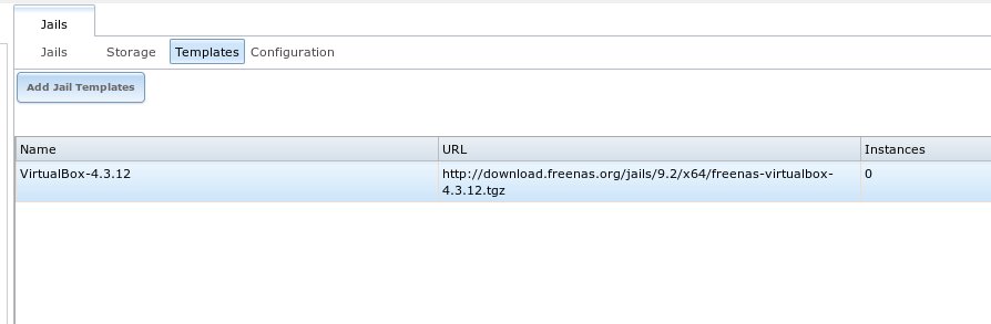

I do not have a "--------" template available on my server. Is it possible to load the template back in since I do have internet access?

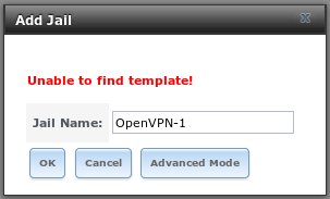

Yes. In advanced mode, I left template as '-----' and it made no difference. After receiving the error message, "Unable to find template," I still had only the VB template listed under Jail/Jails/Templates. I don't understand why it is so difficult to create a jail.
15,504
I have several jails installed on my FreeNAS 9.3 server (some installed under legacy 9.2.something builds, some installed under 9.3.something), and the only template listed under Jails -> Templates is the virtualbox template. Not sure why, and it's not really something I've thought about.
So, you're getting an error message when you try to create a jail. Is there anything in the logs? Under Jails -> Configuration -> Advanced Mode, what's your "collection URL"? My system has http://download.freenas.org/jails/9.3/x64 for that; if yours is different that may be the issue.
mhumm2
Jul 12, 2015
69
mhumm2
Jul 12, 2015
69
mhumm2
Jul 12, 2015
69
Okay, I corrected the url and tested it in my browser. The link works, but when I try to create a jail, I get the same error message. Maybe it's time to look at some other settings that would affect the creation of a jail. What logs would be helpful?
