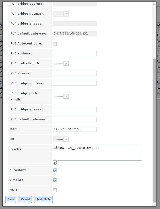

pirateghost
Unintelligible Geek
Feb 29, 2012
4,219
Thanks for your reply.
The configuration in the webpage does not allow me to uncheck the VIMAGE for the Jail. Is there a way to do that through any configuration file?
it does if you hit the 'advanced' button on the jail configuration.

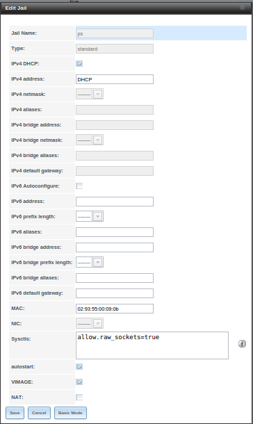

Marcelo Ruiz
Oct 8, 2015
20
Thanks for your reply... Sorry if I wasn't clear, but I did find how to get there. The problem is that the web interface does not let me remove the check to disable VIMAGE.
I am editing this answer to give another piece of information: I was just wondering if it could be related to the browser (Firefox), so I installed Google Chrome and the problem still exists. I can unmark "autostart" but I can do nothing with VIMAGE. The Jail advanced mode looks like this:

Is the jail running? I'm pretty sure you can't change that setting on a running jail.
Marcelo Ruiz
Oct 8, 2015
20
Thanks for your response. I tried both with the Jail running and stopped, but I could not do it.
Marcelo Ruiz
Oct 8, 2015
20
Could anyone of you please confirm that you could create a fresh jail with the defaults settings (like the ones showing in the picture I uploaded) and are actually able to unclick VIMAGE and access the Internet from within the Jail?

depasseg
FreeNAS Replicant
Sep 16, 2014
2,874
I can not uncheck VIMAGE (nor NAT). I tried with the jail running and not running with the same results.
I guess that should make you feel better. :)
EDIT: if I uncheck IPv4 DHCP, then I can uncheck VIMAGE.
Marcelo Ruiz
Oct 8, 2015
20
Gee, I guess you're right... until now I felt I was the only one facing this problem.
So I unchecked IPV4 DHCP and then I could uncheck VIMAGE and ping my router and access the Internet. If I restart the Jail, the old settings come back (DHCP is reactivated in the Jail) and I cannot access the Internet anymore.
Should having no way of disabling VIMAGE to gain Internet access when DHCP is active -the default setting in a fresh FreeNas install- and/or the no persistence of the settings after restarting the Jail be considered a bug?
