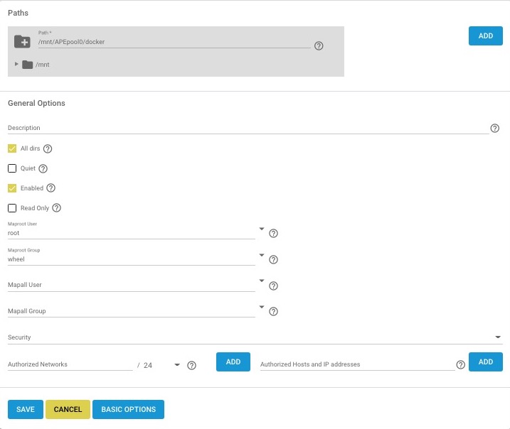

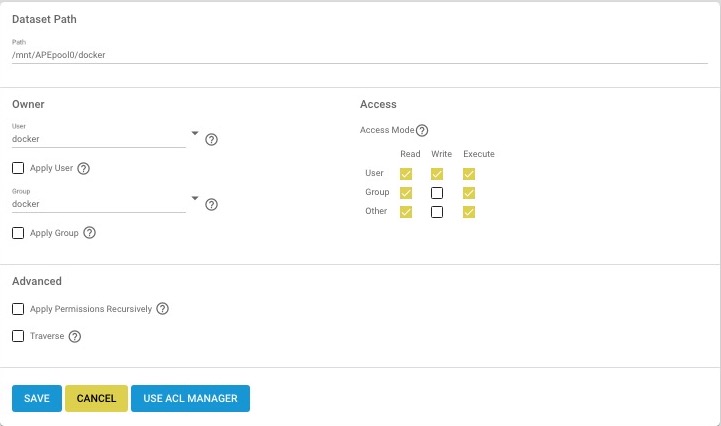

I don't think I've got anything special going on.
Docker dataset on my pool (APEpool0)
NFS share
/etc/fstab line inside the jail
IP:/mnt/APEpool0/docker /mnt/docker nfs nfsvers=3
I've got several containers running which save persistent data back to their own folder within /mnt/docker/container.
