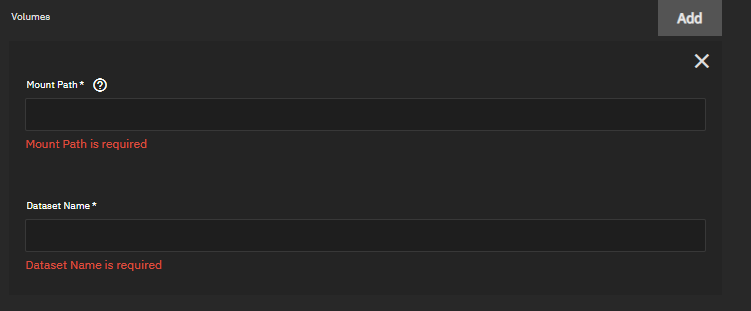

But haven't figured out how to add the volume hostpath via the launch docker image.
I thought I had to implement is in the fields below. It asks for a mounth path and a datasetname.
I am not sure what to fill in. I have the serial link like this /dev/serial/by-id/my_serial

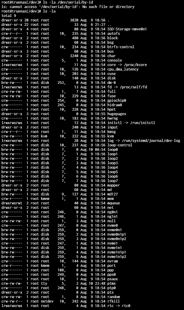

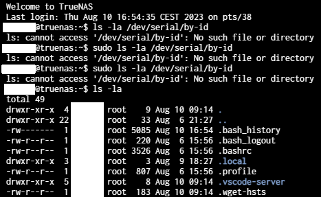

ls -la /dev/serial/by-id
Thank you for your reply. I was finally able to try but this does not seem to work?
Doesn't work with sudo either.

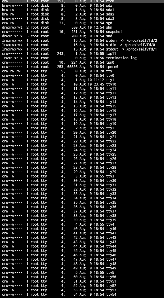

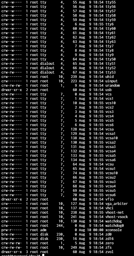

If I use ls -la I get this list not sure what to do with that to get a serial.
I also do not have the mentioned directory is that normal?
I re enabled the root user and now the list is alot longer but the command still doesn't work

9,700
Yes it is plugged in and is working in a vm where it is passed through right now.
So your host can't see it because it's in passthrough... nothing surprising about that.
