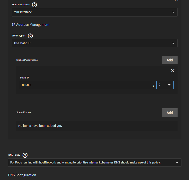

Hi I am using the launch docker image at the app section. I have some apps working but some apps need host network access.
But I find there is not much documentation and unaswered questions through forum.
I need to put in net=host because some apps need to be on the home network. How do I do that? how do I add stuff that is normally in the command lines when a container is started? I am searching for days on the internet how to do this... Or what route do I need to have access to the network? Perhaps I am using wrong search terms but I can not find any good explanation on how to use it.
The only thing I found was a solution here on forums by someone, but I have the feeling it is wrong.
They put in a static ip for example 192.168.8.11 for the container.
Then a static route was created by 0.0.0.0/1 and 128.0.0.0/1 and then it works. The fun part is 192.168.8.11 can be pinged from windows but it is not reachable on the designated port. Then the host ip 192.168.8.2 (truenas host) with the designated port 9004 is reachable and connected with the network. However the IP 192.168.8.11 is also taken up on the network?

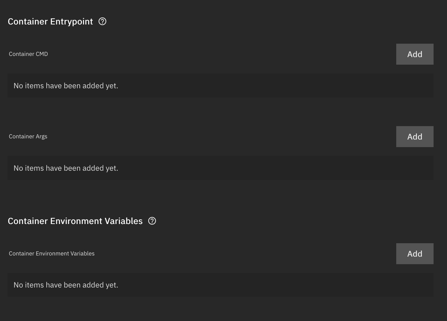

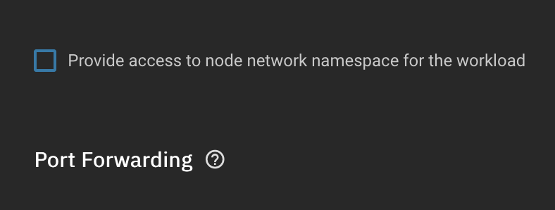

Care to explain how the gui should be used to add docker variables that need to be put in? like for example --net=host?
9,703
Tick this box.
Add items here:

I mean I do know where to put environment stuff but all the other stuff I sometimes see.

Should this be it? for host?
No. That's not anything like what I said.
You don't define an IP address to use host networking, just do nothing in that section.
