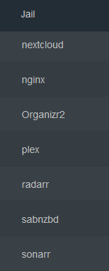

Following apps I'm running with 3-4 users on it:
docker:
iocage/jails:
would probably make sense to move everything to docker in future, so yes, I would need something which runs all this apps on one docker server. Ubuntu 19 VM with docker on it would be good?
