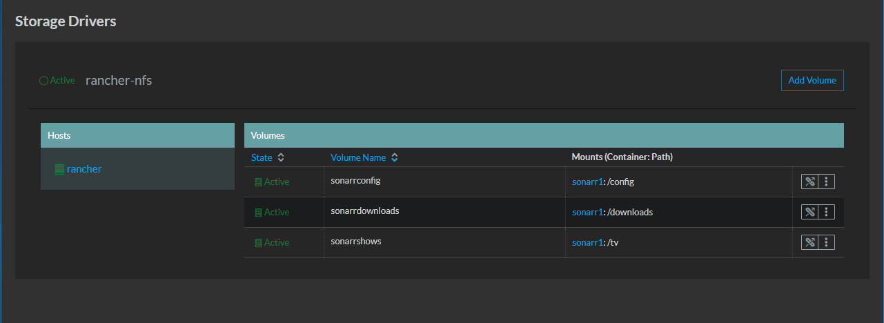

So i've got volumes in rancher 1.6 75% working. 2/3 volumes work. My download folder is mapped correctly and so are my TV Shows just not the config for sonarr. It is setup the same as the other volumes with the same permissions so i have no clue.

I think I know what you mean.
It looks like this:
sonarrconfig:/config ive also tried sonarrconfig:/config:rw
But I’ve just noticed even though the folders are being created in the right spot (except config) the folders are actually empty, so no downloads and no shows.
So the top folders are mounting but not what’s underneath and with the config the container is creating it’s own Sonarr folder and placing the files in there instead of mounting my sonarr folder as /config. Hope that makes sense.

You can help docker to understand that it’s a directory you’re mapping by doing it like this:
sonarrconfig:/config/:rw
Then it should be a question of permissions after that.
Just another thought... are you specifying at the bottom that it’s rancher-nfs storage?

I just tried adding the trailing / as suggested to no avail. Yes I am specifying rancher-nfs at the bottom.
What permissions should I have on my datasets / folders in FreeNAS and also in nfs shares?
