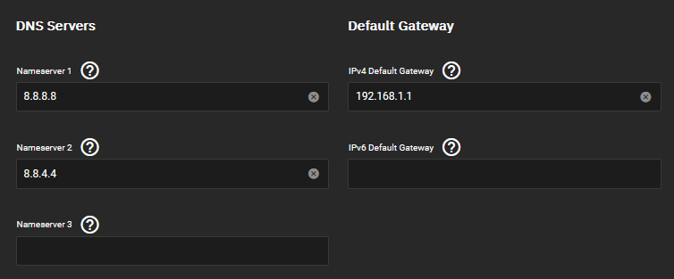

I recently setup my TrueNAS scale, it's on the most recent version, and I seem to run into issue after issue. Right now, the DNS is not working within my applications, but works within the main shell.

I am not as familiar with linux, and have no idea why this would happen. My programs are installed through TrueCharts because I have had better luck with programs installed through that, but it happens with apps installed from official charts too. I manually set my IP and DNS in the network settings on TrueNAS.
If I were to try and update the gravity in pihole, it gives me a DNS resolution error. I cannot connect to any external site on any of my apps.

did you set your network settings in the webUI? don't use the CLI. any settings there can revert at any time.
screens of the webUI instead of resolv.conf would make more sense.

I set it using the web interface.
