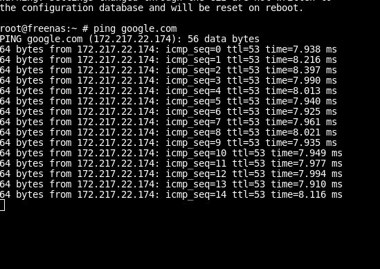

Can you ping out from the shell to say google.com? 8.8.4.4?

Yes I can ping both google.com and 8.8.4.4 with default gateway as 192.168.0.1 and name server 1 & 2

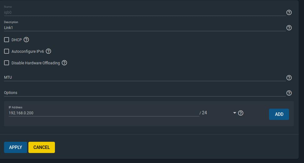

Please post a screenshot of the Network/interfaces/Edit page for igb0 - like this one
To Legacy boot you would have to choose at install when creating a new boot drive.
But this is an upgrade from a previous version that did not have problems?
Yes this was a upgrade from 11.1 U7 that worked with these settings.

OK, so far all this looks logical.
