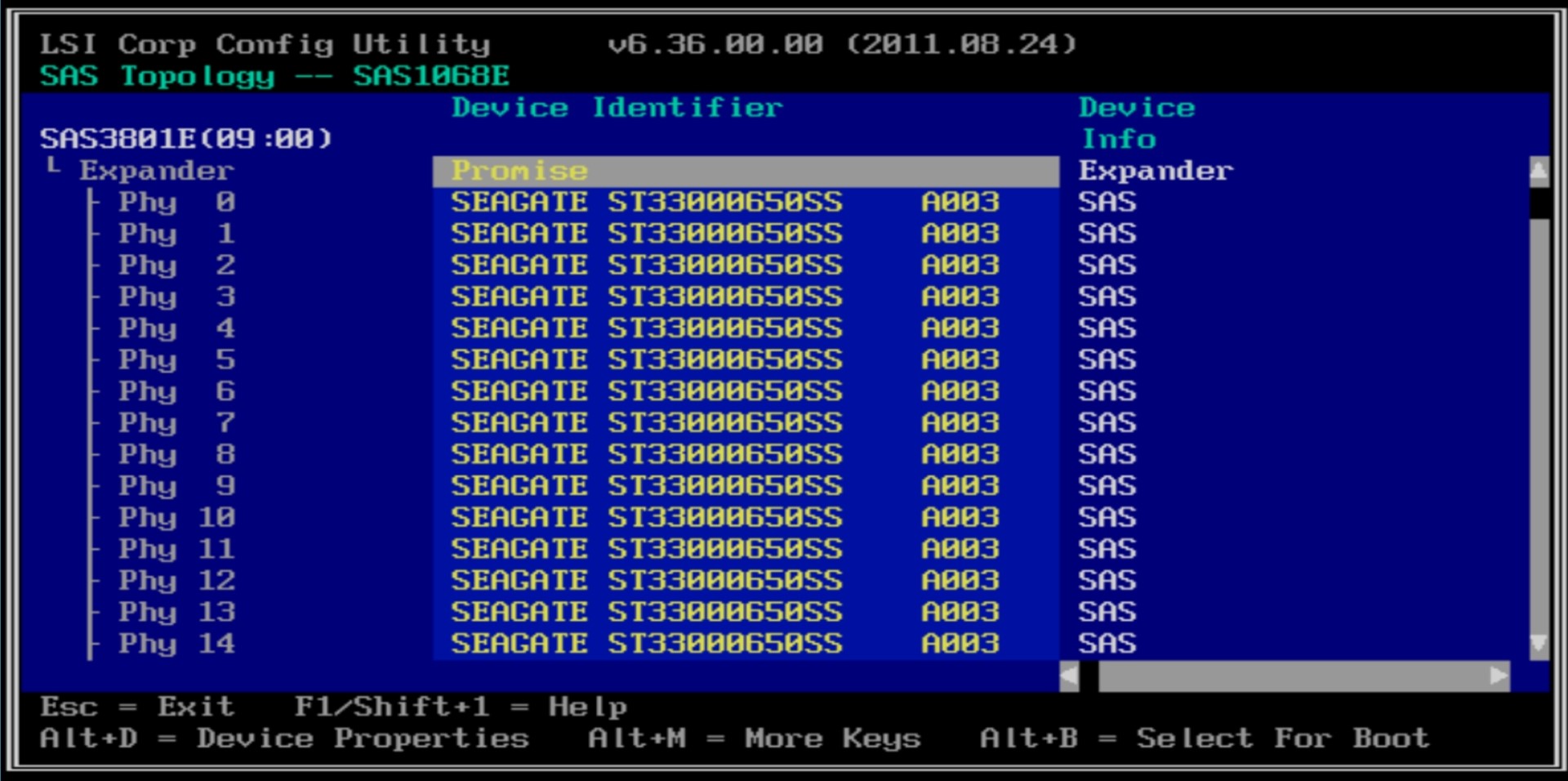

The drives have always appeared in the HBA-BIOS/utility, no problem there it seems. I look there before FreeNAS starts, ofc, and they are there, but not in FreeNAS until i re-plug the cable to disk shell.

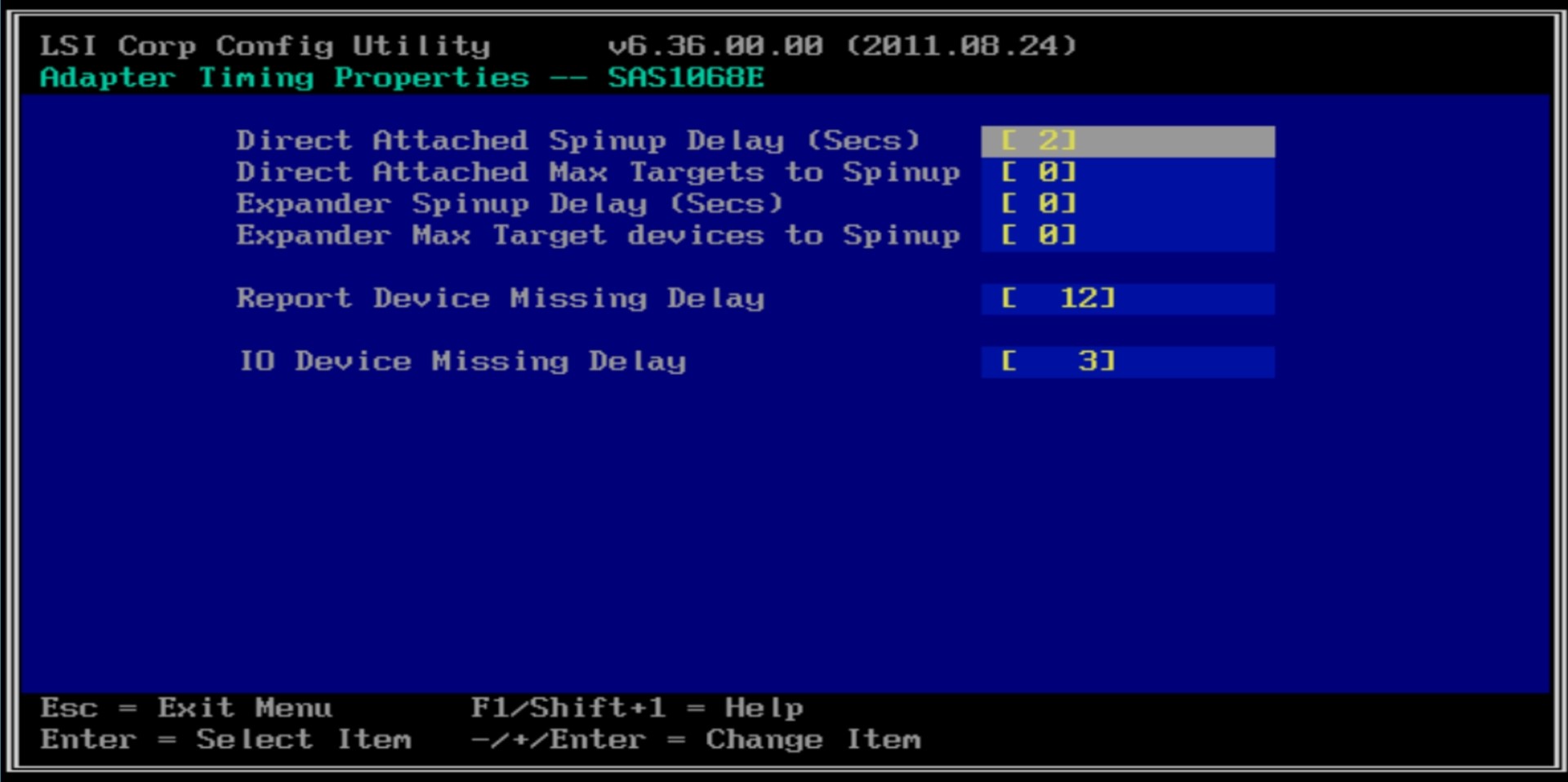

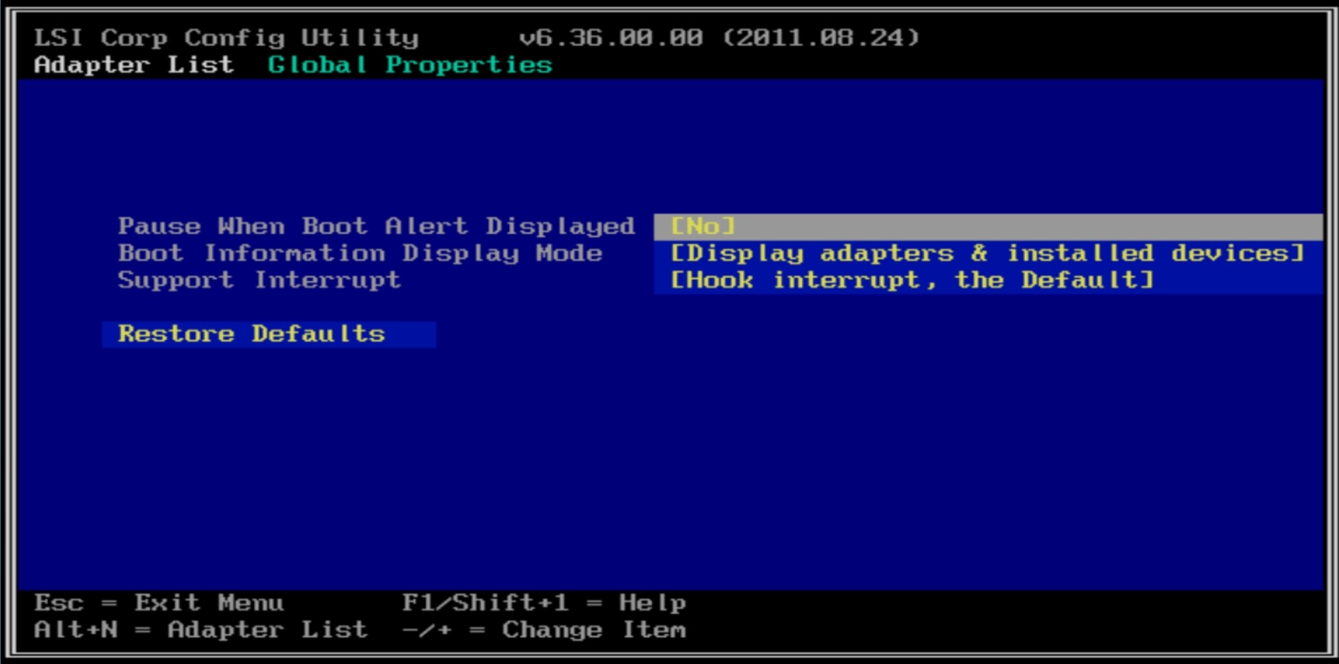

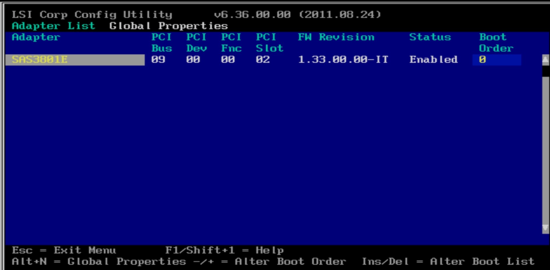

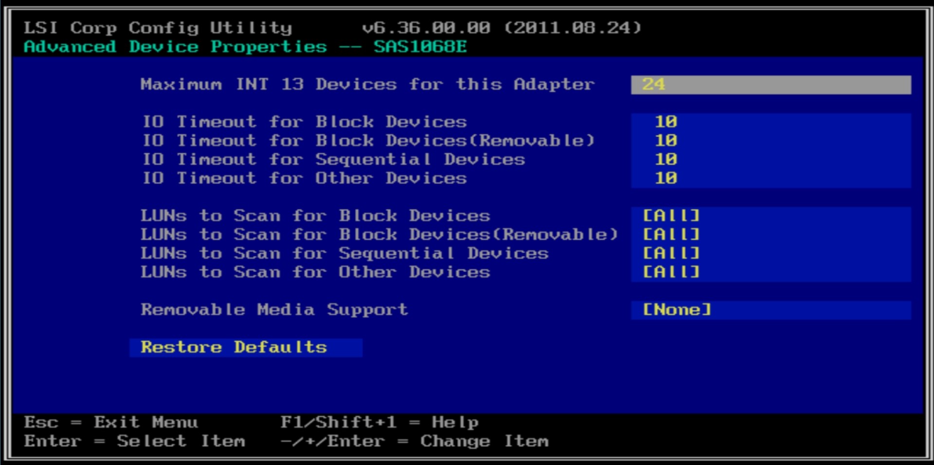

LSI Config utility - settings possibilities..
Boot support - Enabled BIOS & OS // Enabled BIOS // Enabled OS // None
and....
Disks are always found here.

First, don't change a thing based on what I'm gonna say. I have zero experience with this HBA, which means I could be saying something totally wrong that could cost you everything. Maybe someone who is familiar with this can chime in however.
Two things stick out. the first probably doesn't matter, but max int13 devices=24?
The manual https://www.supermicro.com/manuals/other/LSI_HostRAID_2308.pdf
says that it does accept a value of 0. int13 means bootable, and you say you boot from drives connected to the motherboard, not from these disks. There's no need for any of them, let alone more than actually exist, to be bootable.
But the spinup delays, those may be problematic. Looks like a non-logical combination. "Every two seconds, spin up zero more drives."
I haven't seen this with SAS, but I did years ago with SCSI. A drive set to delay spinup, if the controller wasn't set to issue that command wouldn't spin up until the first time you tried to access it- which of course took many seconds, which of course meant it timed-out. Sounds a lot like your current situation.
This is part of my own experiment/learning at an school.
Keep working on it! :)

There is absolutely nothing to be lost here, in this setup :) no critical data or anything, so no worries. Ofcourse i don't want it to set on fire tho, and i do want it to work :).
The settings in my screenshot is just from playing around, I had hoped to make all values default, but couldn't find, only part of it.
I was thinking the spinup delay was about how... when you first plug in the disk shell, that it shouldn't create a big spike in power, but that wouldn't make sense, since it can also be powered without the controller.
I will play around more with it today.
