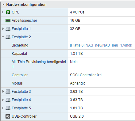

"You are using ESXI. How are you passing the disks into the VM? This should be done with some sort of hardware passthrough that needs VT-d. "
I hope this picture shows what you need:
The other HDDs are similar "plugged" into the FreeNAS-machine.

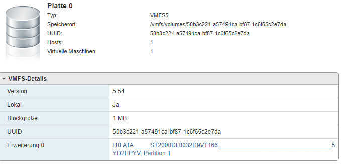

The storage in ESXi for this HDD is:
This system worked very well the last years...

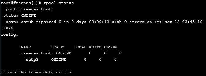

"Also, could you post the output of zpool status?"
I hope this is what you need:
