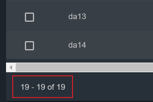

Just starting with FreeNAS (11.2-U3) and in Storage > Disks I see all 19 disks:
When I go to create a pool however, it's not showing the last HDD (da14):
What am I missing?
Thanks

Can you see the disk/create the pool via the legacy UI? Try that first just in case it's a UI/UX bug.
If not, then let's look at maybe there being a partition or other leftover cruft on the drive that you need to clean up.
At least ONE of the disks listed under disks is going to be your boot disk and you can't use that to create a pool.

Thanks for the replies. Yeah Chris got it. It wasn't showing the last drive but reseating it has fixed it.

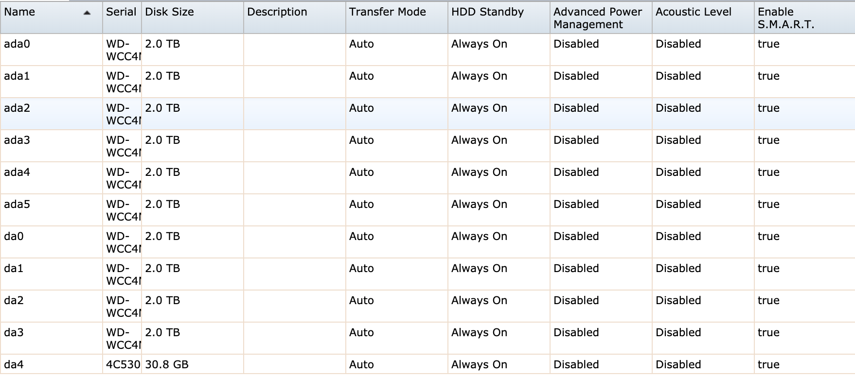

Hello,
the topic is unfortunately a bit older but I have the same problem. da4 is the boot disk and da3 is not visible in the Volume Manager all other hard disks can be joined together to a pool.
geom disk status
Name  Status  Components
ada0     N/A  N/A
ada1     N/A  N/A
ada2     N/A  N/A
ada3     N/A  N/A
ada4     N/A  N/A
 da1     N/A  N/A
 da2     N/A  N/A
 da3     N/A  N/A
 da4     N/A  N/A
ada5     N/A  N/A
 da0     N/A  N/A
ada0 - ada5 directly onboard connected
da0 - da3 connected to a LSI controller
10 WDred 2TB
LSI SAS9212-4i4e Controller
FreeNAS-11.2-U6
Thank you in advance!
Heracles
Feb 2, 2018
1,401
Hey Snorp,
DId you mirrored your boot device ? That may be what use both da4 and 3...
Heracles
Feb 2, 2018
1,401
Hi again,
That screenshot is from the old WebUI. I recommend you get yourself familiar with the new one.
So all your 10WD drives are there. What is missing ?
snorp
Jul 10, 2018
35
Hi again,
Right, you can see them all. But the last hard disk (da3) is missing in the Volume Manager to create a pool.
