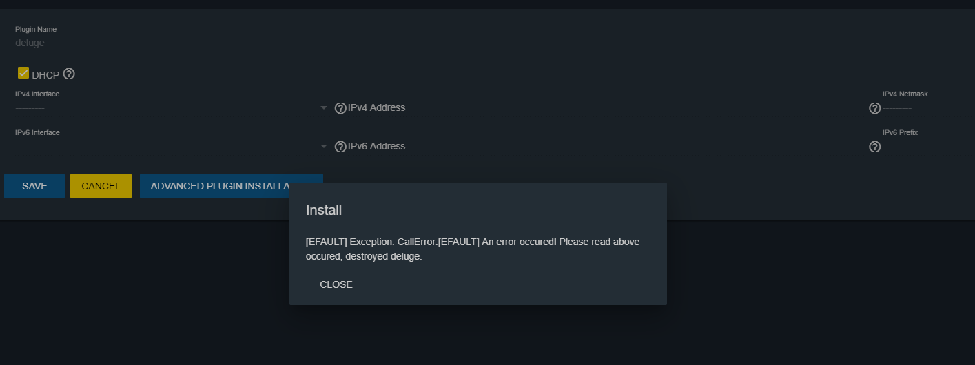

I am having trouble install the Deluge plugin.
Fails at 90% when it starts to load post_install.sh
I tried to remove the iocage dataset and have FreeNAS recreate it, but still same issue.
One thing I noticed is that its pulling the files for Deluge from the unstable branch (http://pkg.cdn.trueos.org/iocage/unstable/All/)
Anyone else having this issue?

I've been getting the same thing these past few days! I was about to create a new topic but hopefully somebody will help on this one.
I think it has to do with the Deluge version 1.3.15_8 since I the 1.3.15_7 version was installing and working perfectly fine on my other machine.
Any help would be greatly appreciated since there isn't much info online.

If nobody knows how to resolve this issue, would anybody know how to manually install the previous version of Deluge 1.3.15_7?

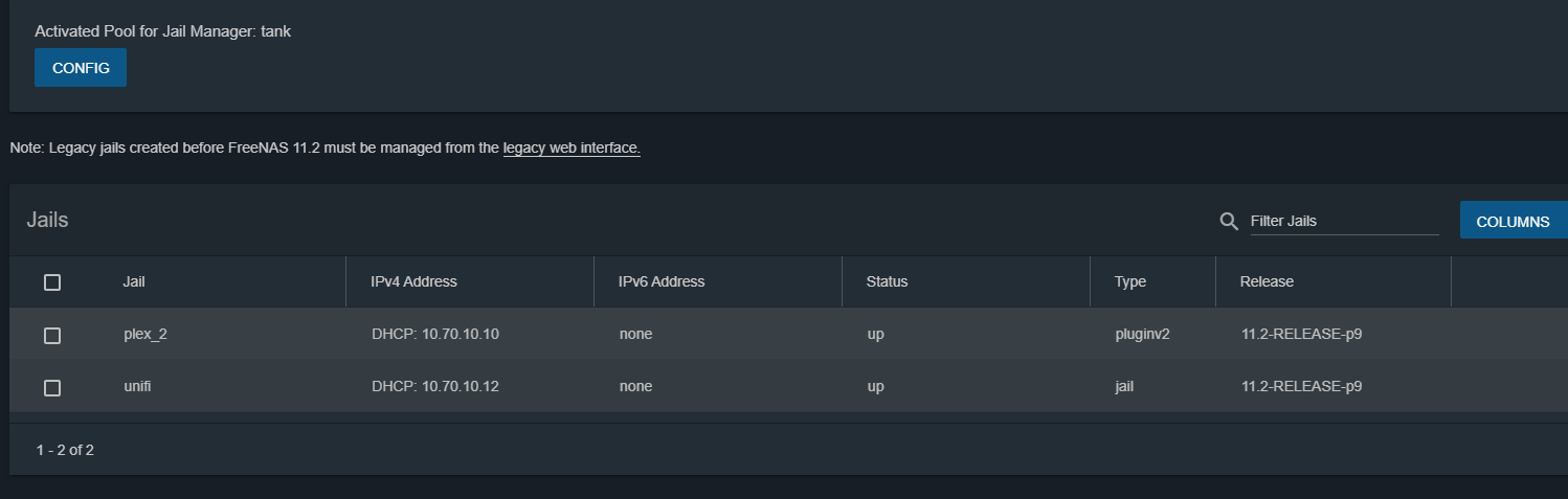

I'm now getting the same thing.
Everything was working (Resilio & Plex) and then today I noticed them BOTH dead.
I could not access them at all but they were both online.
Only thing i have been messing with the past few day is the permissions for the folders and users/groups.
I'm trying to add another PC to my house and setting up folders for that PC only so it can't see the rest of the folders (kids PC).
Did i mess up something else?
My "hand made" Unifi controller jail is still working just fine.
I deleted the Resilio Sync jail and tried to reinstall after noticing i could not access it at all but NOW i get the very same EFAULT.
Sometimes is just hate myself for touching this thing....
I AM able to install any other plugin (but the ones i had already installed, plex & resilio) without any issues AND i'm able to install a jail manually with no issues.
I am also able to PING google.com and check for FreeNAS updates so internet is good.
Do i need to fully wipe my FreeNAS and start over? CRAP!
