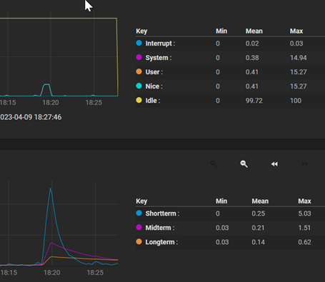

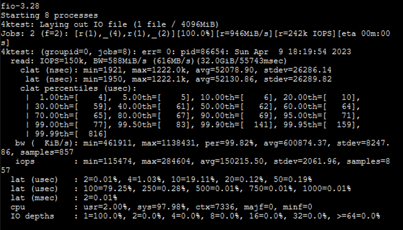

I know I'm parachuting in on an old thread...
Just ran the same fio test on a Gen3 R730xd dual 14core 3rd gen E5-2690 @ 2.6Ghz. Like the other tester, lots of RAM (maxed out, Crucial low latency 3200MT/S ECC registered RAM, 768GB). NOT using the recommended HBA330, using the 730 Mini in HBA mode (I know, the replacement HBA330's on order). Ran the test on a pair of Seagate Nytro SAS SSD, which Seagate has proven will saturate any controller up to 24GB/s I/O:
Same. Exact. Numbers. Average 150K IOPS. OK. So, it's not even the HBA330. It's not the drives. It's not those particular Xeons (though it could still be Xeons in general, or NUMA, or the Dell memory arbitration functions). It must be the bus architecture, or some kind of throttle/sync to keep everything on the same clock? Whatever it is, Gen13 DELL are not working in this environment as they should be.
