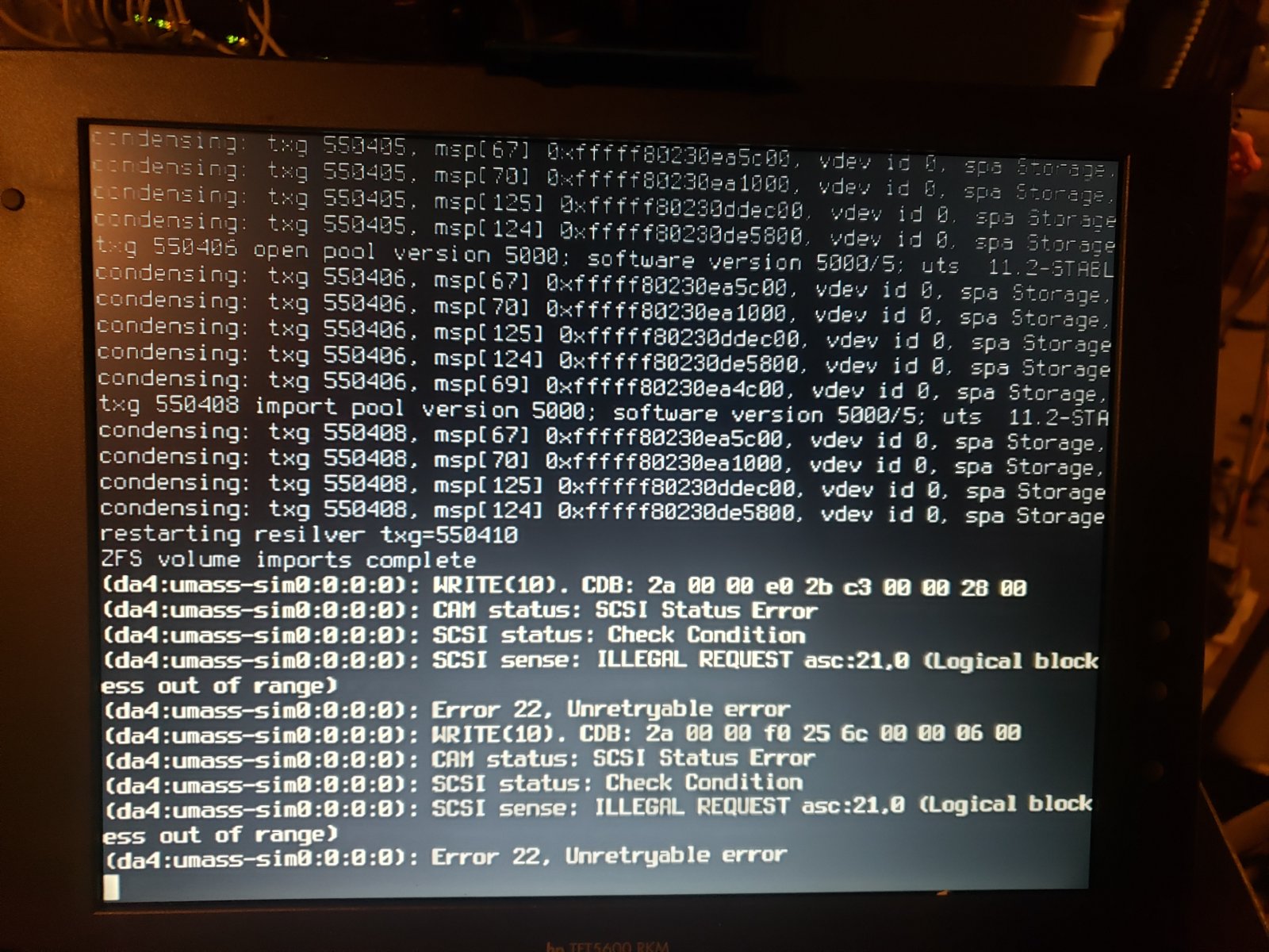

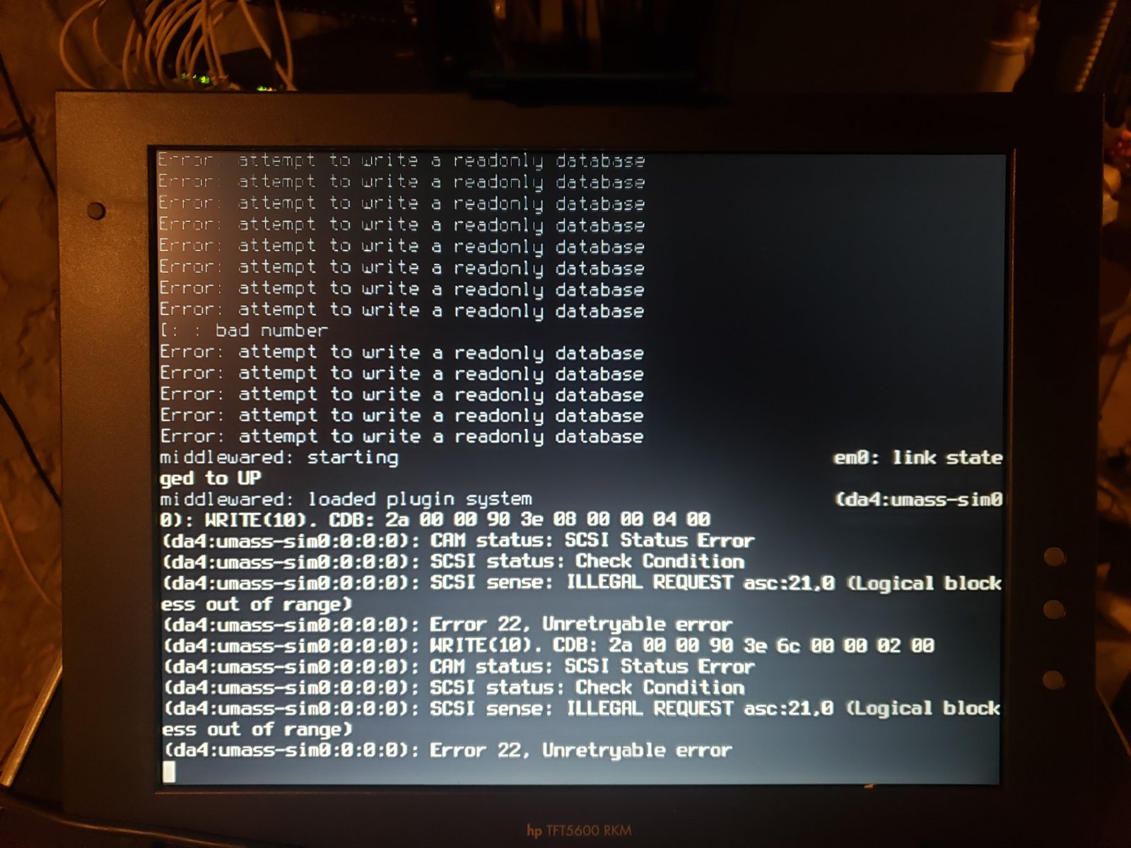

OK... I think... Maybe I need help on identifying if the issue is the boot media (SD card) or a failing/failed hard drive....
I feel like a failed hard drive still boots free as the whole way... But without storage or crippled storage, and a failed boot media would cause it not to boot...
I ask, because, please see attached screen shots (phone pics taken of the console connected to free as...)

As long as the issue is limited to the boot device, the pool should remain intact. You need to create yourself a new boot device and boot up your server with it. You will need to re-configure the network interface first.
Once you can reach the WebUI, you will be able to import your existing pool. You do it from the Storage menu ; Pool.
The thing is that all your configs are lost : your shares, users, etc. If you put your system dataset in your main pool (good practice and by default), you should be able to recover a system config backup from that dataset. Once you got it, you can restore it.
After that, you should be back in business : your pool of data and your system config as they were.

Im not 100% sure what went wrong other than the boot device (SD card) got corrupted or damaged... follow that with the keyboard lockup issues (KDB: enter: panic), and trying to use USB3 keys on this rig (it gets REAL tempermental with USB stuff sometimes... though, that may be freeNAS).

That sounds like a defective USB port / USB hub. For that many USB devices to go crazy, it really points to hardware problem. FreeNAS has no problem with USB keyboards, as long as they work as they should. If the keyboard, port or internal hub is defective, it can do that. FreeNAS does rely on the hardware to behave correctly and if it does not, it can create that kind of problems.
Any chance you can try with different port ? Ports from the back / from the front as they may be linked to different hubs ? Have a chance for another keyboard than this one ?
