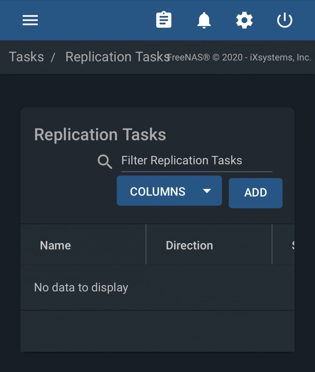

bignellrp
Mar 12, 2020
18
I agree with @John Digital. But do you have an active replication task? If so, you may run into issues after the upgrade to the new boot drives where the replication task fails. I am going through that now and have still not yet resolved the problem.
i don’t have any replication tasks but thanks for the warning.
I’ll try Johns method later and let you know how I get on.
