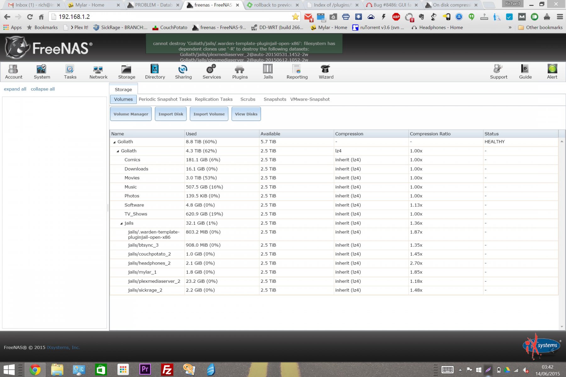

Hmmm, might not have been the best idea after all. One dataset deleted fine but the other one won't budge as it says the file system has dependent clones and goes on to list some of my plugin jails (see screengrab) I tried installing a plugin to see if the missing template dir would be rebuilt, but sadly no dice
Do you think I should cut my losses, back up my var/db/PLUGIN directories and then set up my Jails dataset afresh?
that's what I would do. do double check what you've backed up. for example, transmission keeps it's metadata somewhere else.
