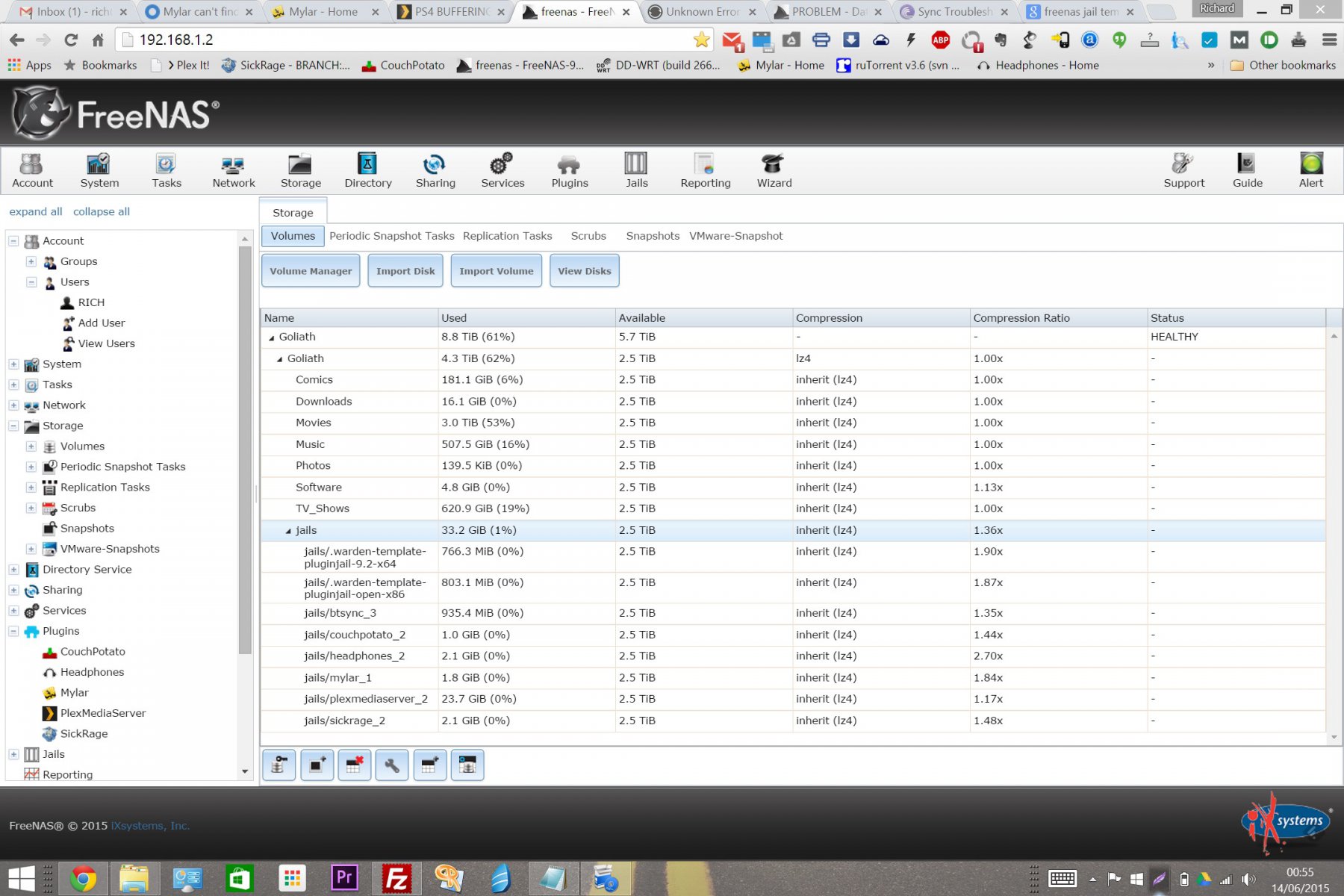

Where am I looking for them?
I've attached a screenshot of my datasets

Joshua Parker Ruehlig

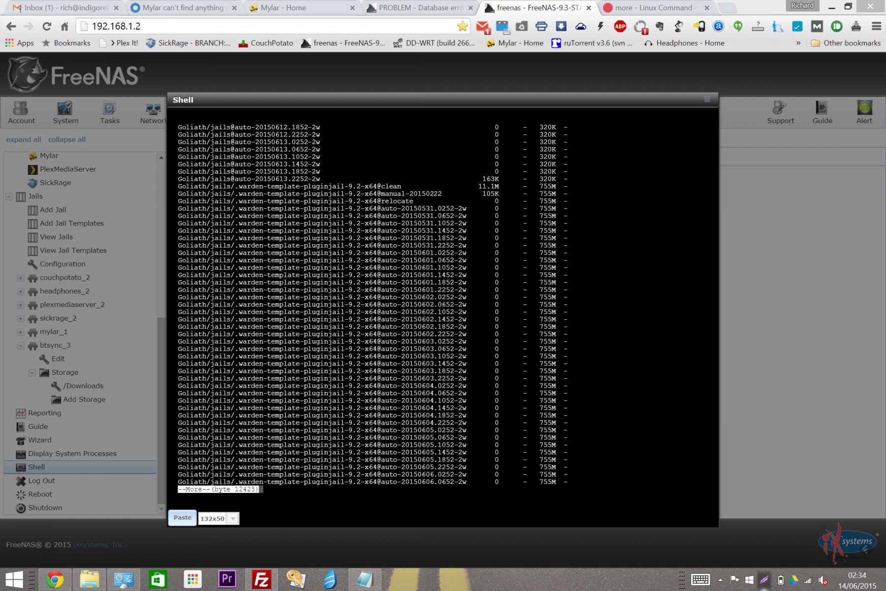

Sorry, i'm being a total noob, but because there are so many snapshots in there, I have no idea how to scroll back up to see them!
You could pipe your output to 'more' or 'grep' the output for some keywords

Ok so I don't have exactly these two no
  1. tank/jails/.warden-template-pluginjail@clean
  2. tank/jails/.warden-template-standard@clean
I've attached screenshots to show what I do have
OK, not sure what else to tell you.
I already said I don't know much about how the jail template work, and you might want to try deleting them. other than that, maybe a bug report at bugs.freenas.org would help so we can forward it to someone who knows how the templates work better.
