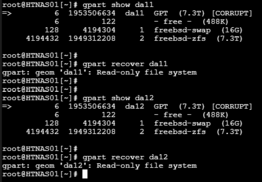

I do see insufficient replicas if I look at the pool status, the SCSI errors are shown in the console output when it tries to bring either of the failed drives online. I did clone one of the failed drives which so far didn't much help but one of the drives seems to be no longer throwing SCSI errors but instead says "The secondary GPT header is not in the last LBA"
gpart Info & Repair Command:
AlexGG
Dec 13, 2018
171
This means your clone is larger than the source. I'm not sure how it affects your specific OS, but generally, it is not a data loss case. The data is still there, plus there are some extra zeros (or junk) after the backup (secondary) GPT header.
HANDLEric
May 6, 2019
47
That's interesting because this is actually being thrown on the initial drive when reattached back to the TrueNAS server. It doesn't appear to be throwing SCSI errors any longer so I feel like if I can overcome this read-only/mounting issue I might be able to get the pool back online.

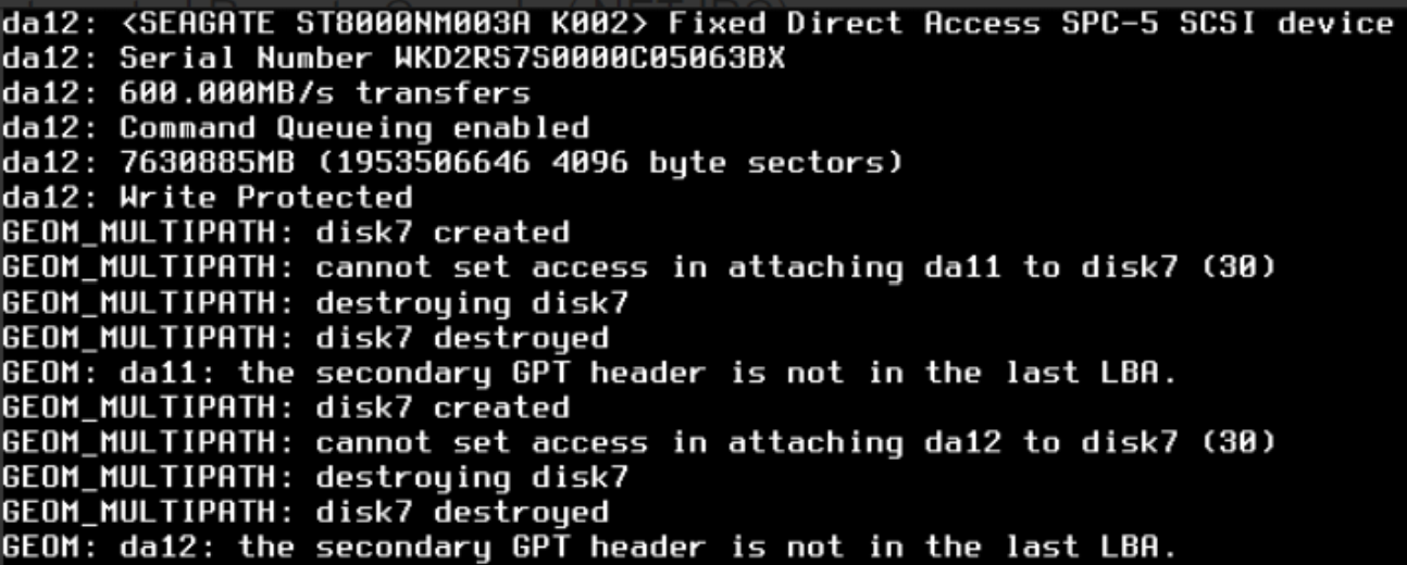

Strange that it's called out da12 as "write protected" in the dmesg - the model number doesn't return as a SED drive so it's not a locking issue there. I'm worried that something in the firmware kicked it into a read-only/premature fail state as a "safety measure."
Did it do this for da11 as well?
HANDLEric
May 6, 2019
47
Both paths (da 11 & da12) did, yes.
