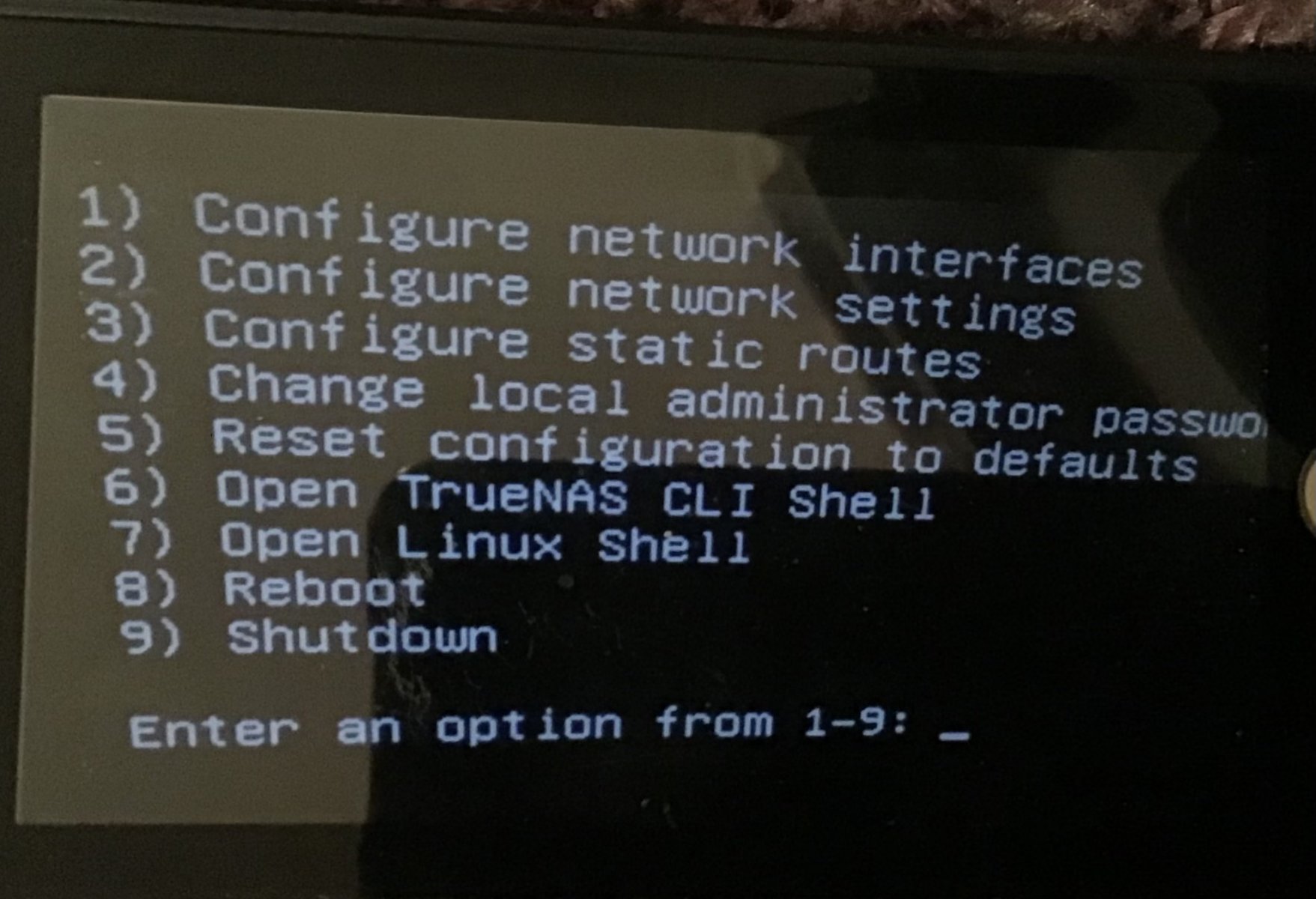

Hello,
Thank you for your reply.
This is going to be a dumb question, but where would I type “zpool import”? I’ve tried it in 6) open TrueNas CLI Shell, but to no avail.
Thanks again

It'd be at the Linux shell. Damn iX for making this more confusing than it already was.

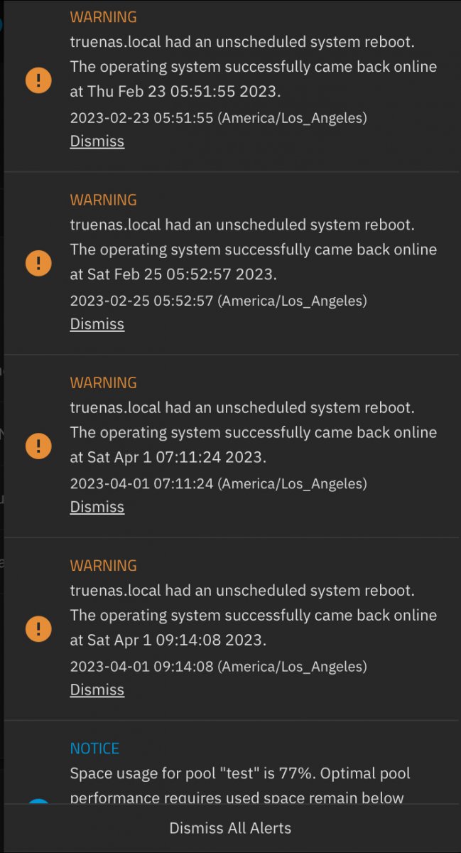

I’ve been thinking about the drive failures. They were two “shucked” hdd drives. I’m aware that this is frowned upon and not advisable. As this my first NAS build I thought I’d use these drives to see if the videos and music would play on plex/could be accessed on my laptop/ios devices (they did), and to confirm whether my build was successful. As the media played I thought nothing of it.
I’ve noticed I had the following notifications:
Upon reflection, were these notifications an indication that there was a flaw in my build?

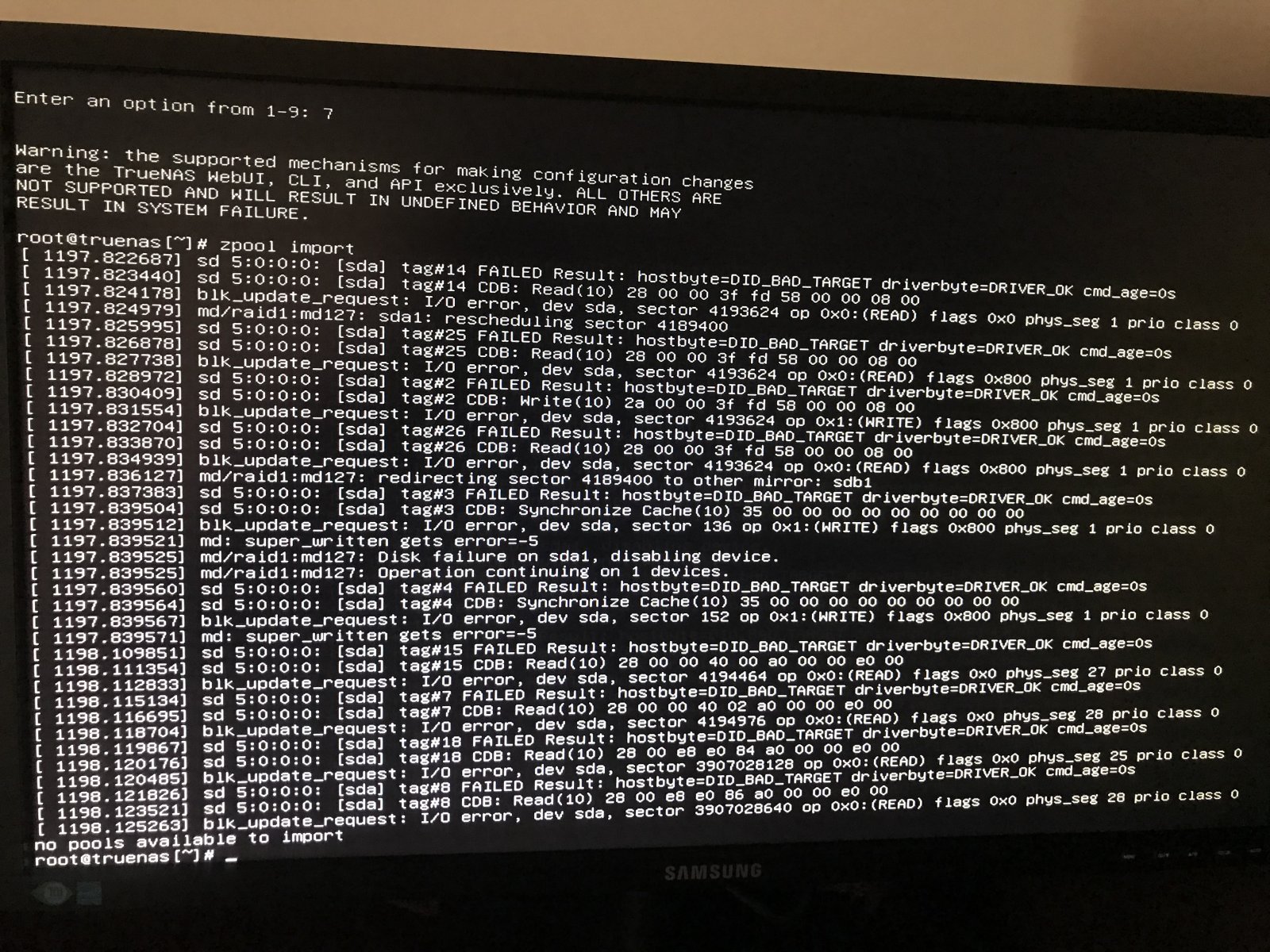

Hello again. I’ve typed zpool import and this is the screen. I’m guessing there’s nothing that can be done?

Arwen
May 17, 2014
3,611
Unless you have a straight forward problem with cabling, power or host SATA port, their appears to be nothing attached that ZFS can recognize.
While extremely rare in a proper configuration, this can happen with:
  • hardware RAID controllers
  • less tested SATA controllers
  • budget, (aka cheap), cabling
  • bad power supplies
  • old, desktop disks
  • And out right over-writing them with MS-Windows or other method
If you are positive that your disks are wired correctly, and both show up with other software tools, then ZFS is telling you they do not have a ZFS pool on them.

Thank you for your detailed reply.
I think I will accept defeat with these two drives. I’ll save up some Wd Red Plus NAS drives and start from scratch.
