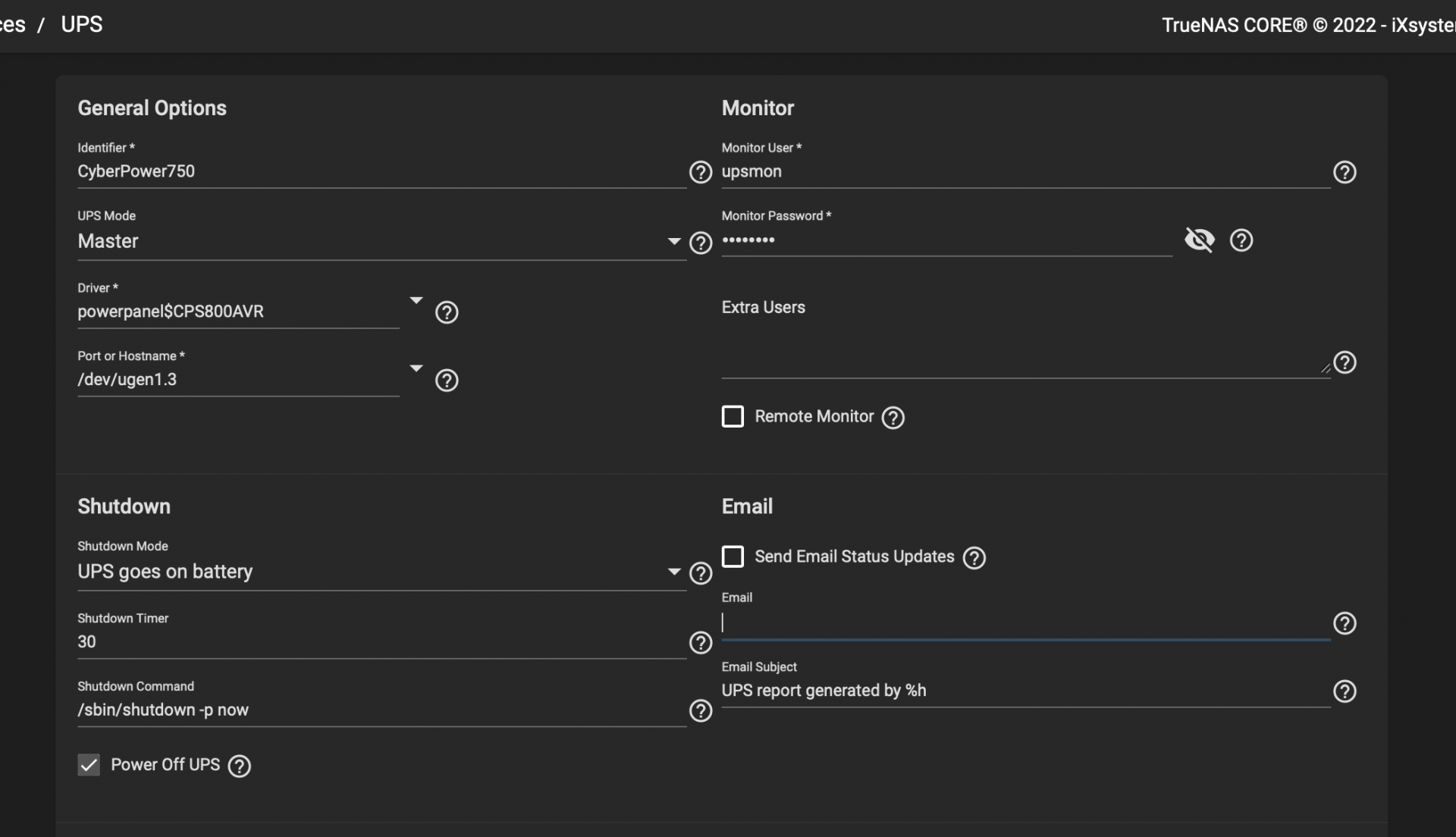

Hey Everybody I recently acquired a CyberPower 750VA. it seems im having issues setting it up. In getting errors connecting it to TrueNas, does any one have any ideas how I can properly Configure the UPS?

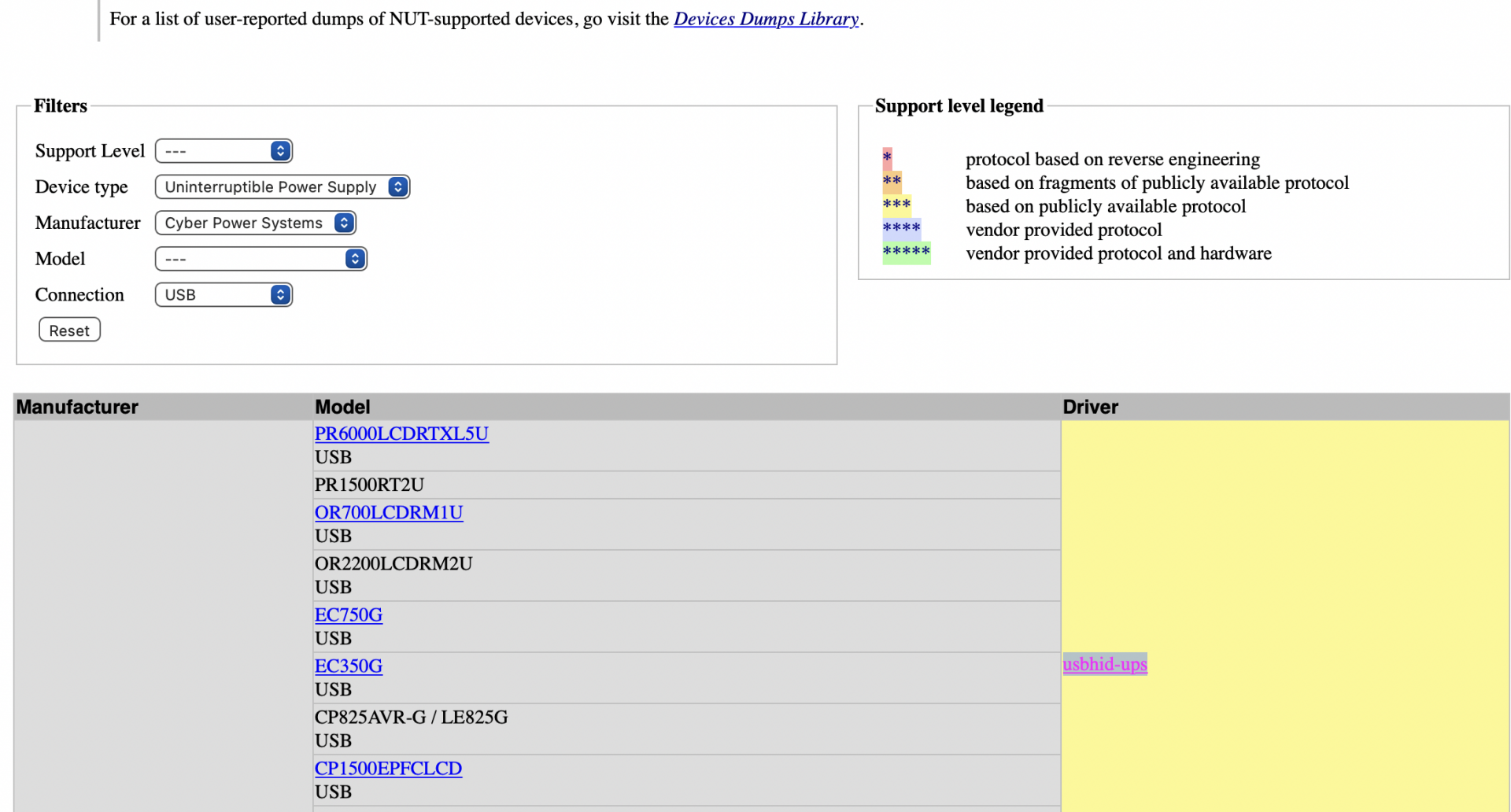

@csearle
TrueNAS uses NUT. https://networkupstools.org/stable-hcl.html
Try the usbhid-ups USB driver, not the powerpanel serial port driver.
Make sure you have the correct USB port selected or leave it in auto.
NOTE: If you connect an additional USB device to your NAS, the USB bus enumeration for the UPS may change, thus it is best to leave in auto.

WOW.. Thank you for the useful tools that worked perfectly....

SoI have a CyberPower 750VA UPS it worked flawlessly for about a year I had to power the server it was connected to down to upgrade the ram. When I powered it back on and it came back online I had connection errors to the UPS. I cycled threw the CyperPower plug-ins and found a different one that would work. I recently had to power it down again. Yet again I had to find a plug in that would work, when it came back online.
Im afraid to shut it down again and not have a plugin to use

I have the CyberPower 850VA, and there are/weren't the "right" drivers listed, but I found that using the usbhid-ups$CP900AVR driver has worked for 6-8mo without issue. It's was a bit annoying to 'guess' and various drivers but at least cycling through the cyberpower/CP "AVR" models as a start narrowed it down.
I'm noting this as a note to myself incase I forget the driver I'm using... and since it's pretty related to your post I didn't want to start a new one. If you find a driver that works perhaps you can share which one works for the 750VA incase it helps anyone else in the same boat.

Currently usbhid-upsCPS685AVR Diver is working for me for my 750AV
