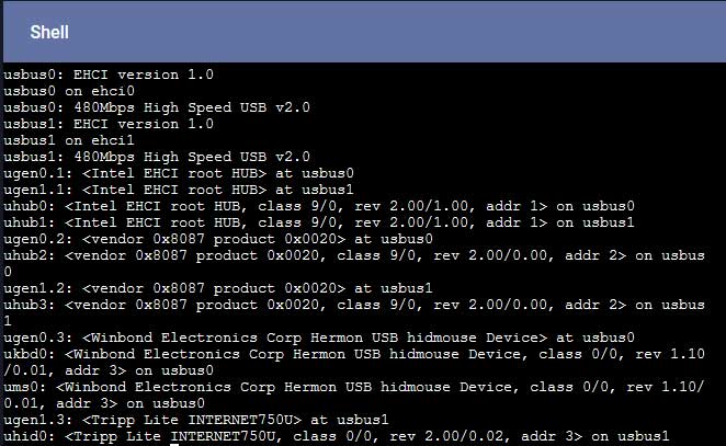

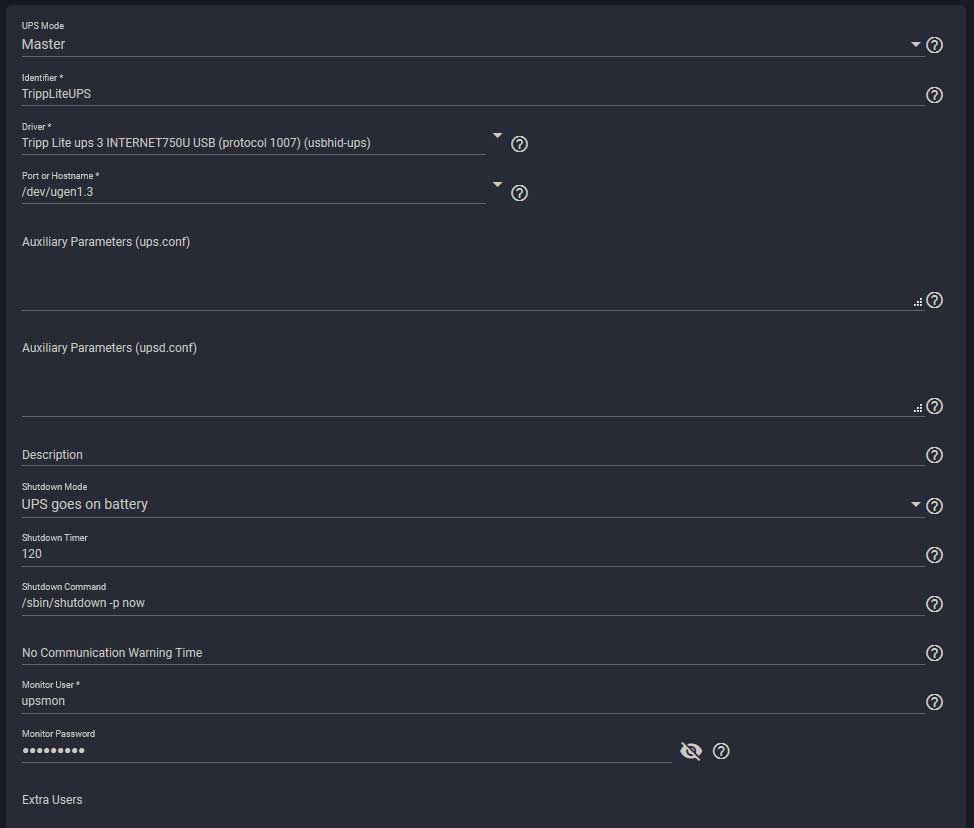

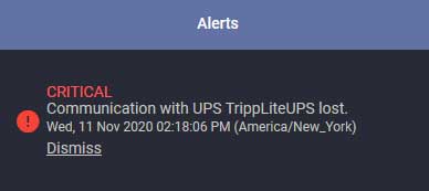

I went to Services -> UPS -> Configure, and I selected my exact model from the Driver* drop down menu and I selected the appropriate Port (for me, ugen1.3) after viewing what was connected on my USB via the shell commands. The rest is standard setup per documentation. The moment I enable the service, it gives me an alert saying that the connection to the UPS is lost.
Here's my USB devices and why I chose ugen1.3 for the Port (I think this is right?):
Here's my setup in UPS configuration:
Here's the alert:
Any ideas on how to further approach this? When I use the shell command to test the UPS it says error connection.

A few of things to try. First, change the monitor password to what you use for root. Second, try a very different driver that is listed as usbhid-ups (e.g., APC). Third, try each of the listed ports. Fourth, make the identifier simpler (e.g., ups). Finally, see if upsc command in shell provides any info. You might also try a server restart as a last resort. Hope this helps.

* I changed the password to match. No success.
* I tried a few different drivers based on the usbhid-ups. No success.
* I tried all the ports and auto. It shows up by name in the list when I use a shell command and is on ugen1.3. No success.
* I have restarted the box. No success.
I'm confused since it sees the UPS and can gather its info and model number no problem. But it refuses any connection when I use the upsc ups@localhost command and it doesn't communicate/connect when I enable UPS services.
