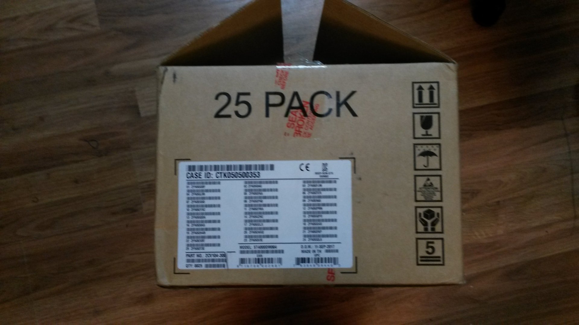

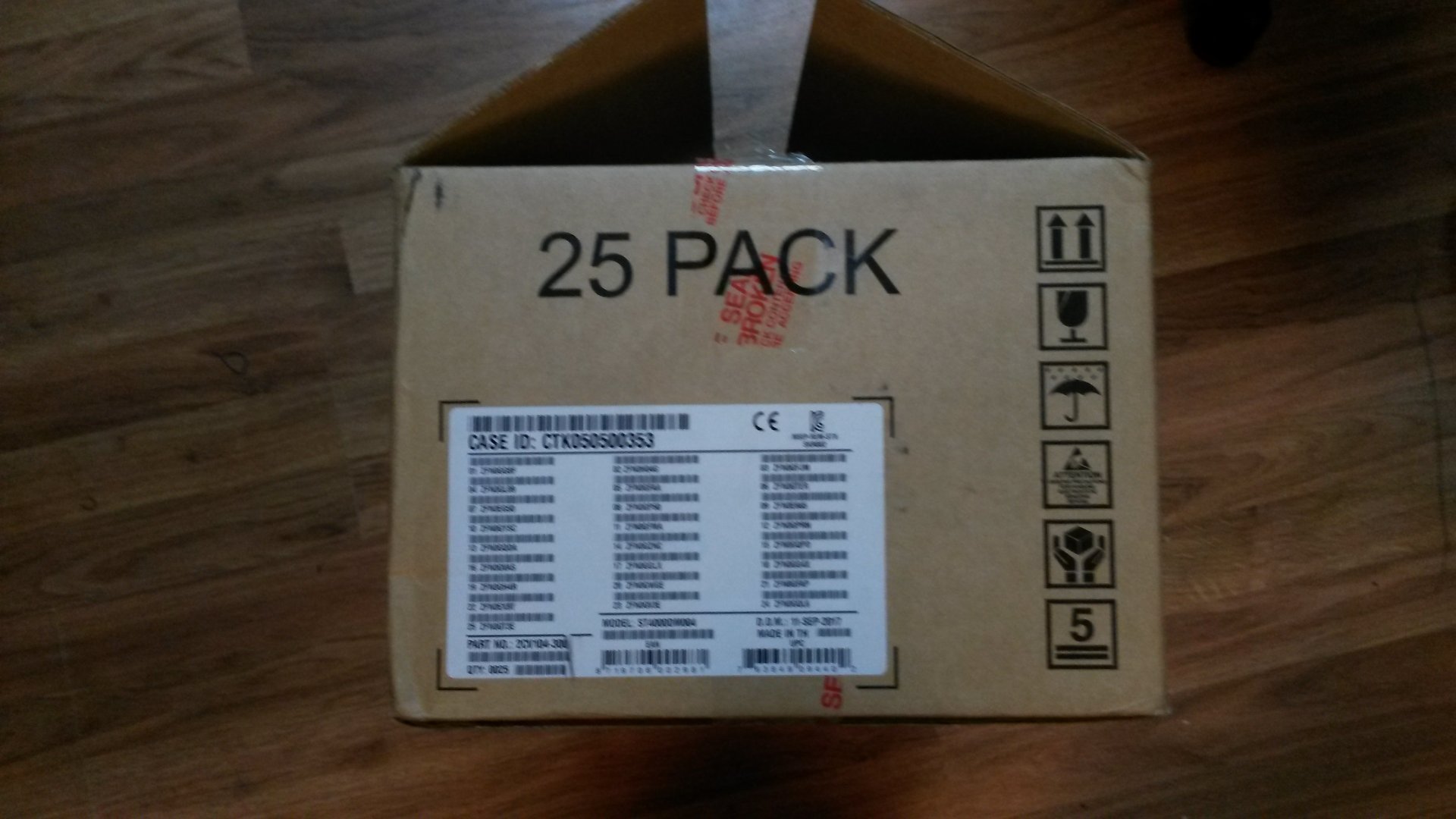

It wasn't just because they got to the age, because I usually wait for the drive to fail also. I have two FreeNAS systems at home with (at the time) 24 drives between them and all the drives were either close to or passed the five years point. I was having a drive or two fail every month and I had two in one day one time. It was getting to be a pain. The other factor at the time was that I wanted more space. So, between the two pressures, I initially replaced one vdev (six drives in my vdevs) with the same sized drives I was already using because those were the oldest and I did a little shuffling of drives. For me it wasn't perfectly straight forward because I have been ruining these systems for years and only replacing drives as they failed so they were not all the same age. This time I was in a little different situation and the other three vdevs got 4 TB drives to expand capacity. It was mainly because I was lucky to come into a really good deal on a quantity of drives at well below retail:
I am still contemplating whether or not to replace the vdev of almost new 2 TB drives that I already put in before I got these 4 TB drives. I normally maintain two or three spares of each drive size that I am using.
It wasn't just because they got to the age. I have two FreeNAS systems at home with (at the time) a 24 drives between them and all the drives were over five years old. I was having a drive or two fail every month and I had two in one day one time. It was getting to be a pain. The other factor at the time was that I wanted more space. So, between the two pressures, I initially replaced one vdev (six drives in my vdevs) with the same sized drives I was already using because those were the oldest and I did a little shuffling of drives. For me it wasn't perfectly straight forward because I have been ruining these systems for years and only replacing drives as they failed. This time I was in a little different situation and the other three vdevs got 4 TB drives to expand capacity. It was mainly because I was lucky to come into a really good deal on a quantity of drives at well below retail:
Sounds sensible. That many failures do suggest a need for replacement.
